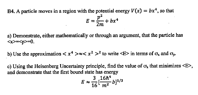

(See attached photo)
I Have no clue where to start for b), i need major help! For a I said that you can argue since the potential is symetric along the x-axis that this operator will go to 0. However I don't know where to start for b) or c).

First write out the formula for ##\sigma_x## and ##\sigma_p## and then use the result from a) to simplify them.
