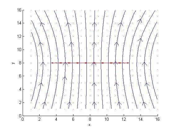

Hello, i want to draw the vector field and see the difference between propagation of field inside the body (with permeability μ>>1) and vacuum (μ=1).
For the picture above i used Ampere's law, ∇xB=J and it illustrates only situation in vacuum. How to implement a contribution for example of iron core? (Red is a current loop)

Same implimentation - make μ\mu a different value.
I think that the question was:
If you insert a lump of unmagnetized iron ( say a ball ) into the field, the field will be distorted inside the ball, and in the outside vacuum as well.
How can the propagation of the field through vacuum and iron be simulated/calculated in this unhomogenous environment ?

... ame implimentation - different mu values - also need boundary conditions.

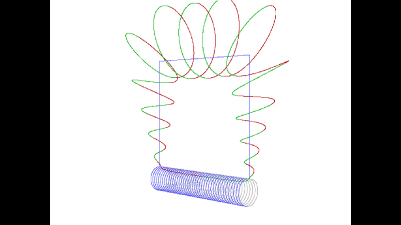

I have attached a solenoid, connected to a frame of wire, just to make flow of current through the circuit possible. Some magnetic field line will spiralize around the frame and will at last bite its own tail. The path of this magnetic field line has been calculated by means of Biot-Savart, and is only affected by the current through the solenoid and the frame.
Now, if I introduce a lump of iron near the solenoid with known position, known shape and known μr, the field line could choose a complete different path.
How will I "tell" Biot-Savart about the existence of this lump of iron, or which other method of simulation must be used?
If in doubt, you can always use a grid and iterative numerical simulation of every voxel of the grid. Some approximations can be useful to simplify the problem.

My main goal is to verify that the path of a magnetic field line always will be a closed loop (Amperes law).
The path in #6 closes up with an accuracy = 0.06%, measured as:
Error = ( distance between start, end ) / ( length of path ) * 100%
The method is simply to follow the direction of the magnetic field with a 3D compass.
Maybe some day I will make a movie, seen from a camera onboard a small airoplane flying through ( a lot of ) magnetic field lines and solenoids. Some lumps of iron within the airspace will be welcome here. :smile:

Also I can see that if the electric circuit is not closed ( removing the frame in #6 ), a magnetic field line will not be closed ( error = 1.6%, whatever ). That's why Amperes law is said to be only valid in connection with "infinit long wires", etc.
I don't know if there are things like magnetic monopoles in a fusion reactor? But Biot-Savart and Ampere seem to agree regarding electric circuits at "normal" temperatures.

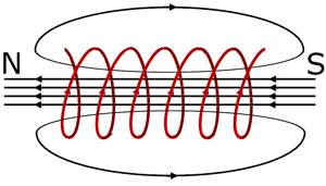

No, it is not. This figure is wrong ( found on google ):
The field lines are absolutely symmetrical and closed, though the coil is not. It forms a spiral, not a series of rings. So the field lines within the solenoid should be skew/twisted and not form closed loops. Amperes law and Biot-Savart will not agree in the shown figure. But if you approximate the windings by rings, the figure will be correct.
Furthermore the field lines should spiralize back from N to S, because the windings conduct a current from S to N like a straight wire. So the combination of ring currents and a straight current will form a spiralized field line.
In my calculations a winding is split into 360 parts ( 1 deg. ). Then spiralized and skew field lines will appear, but still the field lines will be closed if an external frame ( like in #6 ) is added to the electric circuit.
I can recalculate the above figure if you wish ( will take some hours ).

It is a good approximation to show the idea of a coil.
