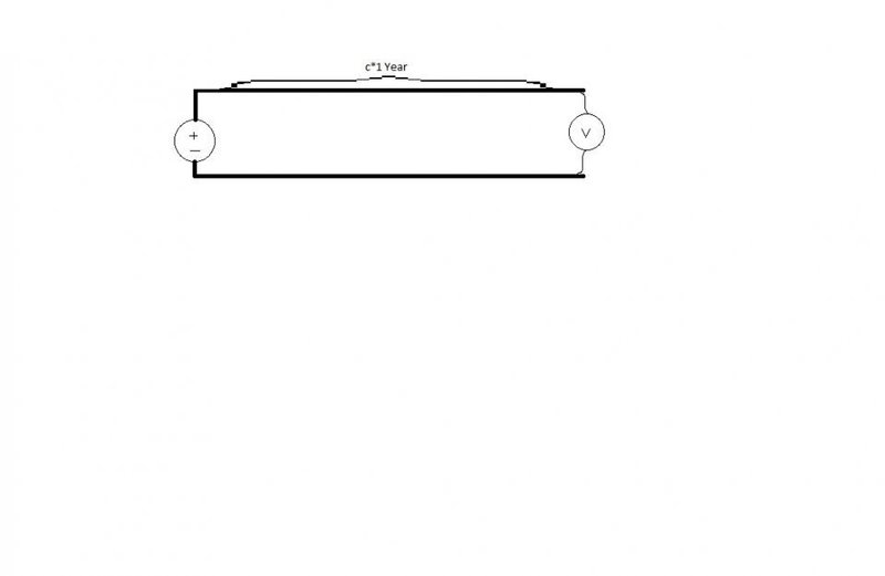

The main question stems from the answer for this one:
If I have a light year long rod and push it on one end, how long would it take for the other end to move?
Still Unsure of this answer.
Main Question:
If I had 2, light-year long conductive rods with a voltmeter attached at the ends then applied a voltage to it, how long would it take for the voltmeter to read the voltage?
Resources/tutorials/wiki pages please for this as well. Thanks!

Thanks for the reply! Yes, I just want a conceptual understanding of the question, so everything is perfect: resistance is zero; the two rods are spaced very far apart. What else might be required for the voltage to reach the end?
Although; what I'm really after is: Which would travel faster, pushing a rod or a voltage through the two rods? Would they travel at the same speed?

The voltage, at the ends where the Voltmeter is connected, arises from the flow of a disturbance in electric field that flows away from each terminal of the voltage source, towards the other end of the rod that is connected to that terminal. Both those flows propagate as waves through the rods, at a speed equal to the speed to electricity through the rod which, if it is made of metal, will be 60-90% of the speed of light (source here). So it will be about 1.1-1.6 years before the voltmeter registers a potential difference. Note also that the voltage source will need to be absolutely gigantic to propagate the electric field so far.
The voltmeter will register a potential difference long before the pressure wave from a physical push reaches the end of the rod.

The result if we measured current would be the same as for measuring voltage. Electrons move to make a current when a voltage is applied to them.
The propagation of the voltage is the movement of a wave in the electric field, not of electron(s). The movement of electrons due to current in a conductor is actually very slow, around 1mm per second. But the movement of the wave is very fast. This is (somewhat) similar to how, in a water wave, individual water molecules move neither far nor fast, but a wave can travel fast.
So we can't think of the propagation of the current as electrons pushing each other. If it were limited to that then the voltage would travel much more slowly than the push from the end of the rod.
Here's a page that discusses the important difference between speed of current propagation and speed of electrons.

In a discussion like this, it is best to approach it, for a start, in classical, macroscopic terms. Ignore photons, phonons and electrons and stick to EM and Mechanical waves. You get a good answer from that approach and you won't risk getting embroiled in how electromagnetic energy actually travels on a conductor.

Just want to "second" what @sophiecentaur and @andrewkirk both just said. There is definitely no need to think of this in terms of electrons or molecules, classical continuum mechanics is fine.
In that sense, the acoustic behavior is not so different from the electrical behavior. In each case the speed of the wave (acoustic or electromagnetic) is different from the speed of the material. If you pound very hard on a steel rod you might make some of the material move at a few hundred m/s, but the acoustic wave will travel at about 6 km/s. If you tap very lightly then the material may only move at a few dozen m/s, but the wave will still move at the same 6 km/s. The wave velocity is a property of the medium, and is independent of the motion of the material which is partially dependent on the strength of the excitation. Similarly for current.
