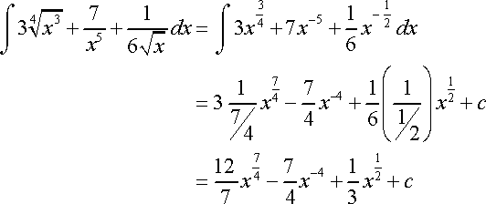

How did they did they do the second line? Any help appreciated, thanks in advance.
  • Worked integration in three lines: integral of 3 fourth-root(x cubed) + 7/x^5 + 1/(6 sqrt x) dx, rewritten with powers, then integrated term by term to 12/7 x^(7/4) - 7/4 x^(-4) + 1/3 x^(1/2) + c.
You know the rules of integration right? Imagine differentiating [itex]x^3[/itex]. You get [itex]3x^2[/itex].
Now reverse the differentiation.
So integrating [itex]3x^2[/itex] you first increase the power and then divide by the new power. So...
1) Raise the power: [itex]3x^3[/itex]
2) Divide by the new power: [itex]\frac{3}{3}x^3[/itex] = [itex]x^3[/itex]
That's all that's happening on the second line.
##\int 3x^\frac{3}{4}+7x^{-5}+\frac{1}{6}x^{-\frac{1}{2}}\ dx=\int 3x^\frac{3}{4}\ dx+\int 7x^{-5}\ dx+\int \frac{1}{6}x^{-\frac{1}{2}}\ dx## using the sum rule for integrals##\int 3x^\frac{3}{4}\ dx+\int 7x^{-5}\ dx+\int \frac{1}{6}x^{-\frac{1}{2}}\ dx=3\int x^\frac{3}{4}\ dx+7\int x^{-5}\ dx+\frac{1}{6}\int x^{-\frac{1}{2}}\ dx## using the constant multiple rule for integrals##3\int x^\frac{3}{4}\ dx+7\int x^{-5}\ dx+\frac{1}{6}\int x^{-\frac{1}{2}}\ dx=3\cdot\frac{1}{\frac{3}{4}+1} x^{\frac{3}{4}+1}+7\cdot\frac{1}{-5+1}x^{-5+1}+\frac{1}{6}\cdot\frac{1}{-\frac{1}{2}+1} x^{-\frac{1}{2}+1}+c## using the integral formula ##\int x^\alpha\ dx=\frac{1}{a+1}x^{\alpha+1}+c## when ##\alpha\neq-1##
