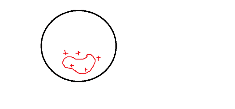

Now consider a hollow conductive sphere with a charged object inside
Hand-drawn sketch of a black circle representing a hollow conductive sphere, with a red irregular closed outline inside its lower left area marked with several red plus signs.
The charges on the conductive sphere will have a different distribution of course. Said another way, the charges will re-distribute from the original one. But, they will do so to satisfy what condition?

1. Charges will reorient themselves keep the condition E=0 inside the conductor. If the net charge inside the cavity is Q, then a charge Q will move from the outer surface of the conductor to the inner surface.
If charge Q is present present inside, and Q is not at r=0 but rather shifted in position as shown in the drawing, please confirm the following
a.) The charges on the sphere will distribute in such a way that doesn't affect the E-field inside the conductive shell. ie, within the shell, the E-field will be solely due to Q(inside) as if the shell wasn't even there.
b.) Outside the sphere, the E-field will be non-uniform because the Q(inside) is not centered thereby making the charge distribution on the shell asymmetric.
