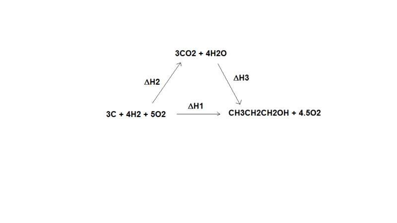

See the attached Hess's law cycle. What are ΔH1, ΔH2 and ΔH3?
ΔH1=-4336, ΔH2=-2326 and ΔH3=-2010 because that cycle gives ΔH2+ΔH3=ΔH1 and -4336. You draw the cycle differently to me, but I get the correct answer when I do it.
ΔH3 is not -2010. Look at the direction of the arrow. How is it related to the heat of combustion of propanol?
