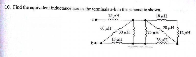

This is the first time I ran into a circuit like this with diagonal wiring and I am not sure how to treat it. Do I add the inductors in the triangle in series? So for example, on the left would it just be 105uH? I don't think that is right. Then that would be in series with the 25uH. How do I do this?
Component arrangement on the page doesn't matter. The only thing that matters is how they connect to each other (the topology). You can feel free to re-draw the circuit with only horizontal and vertical lines and components if you wish, just so long as you maintain all the same connections.
As an indication, at the right end of the circuit 18 an 12 are connected in series and them together are in series with 38. the idea is tha the conductor lines between two connection points are ideal and you can modify their length and form as you wish.
First identify the series and parallel combinations. The circuit collapses into a very simple form then! You will automatically get rid of the diagonal wiring once you spot the series and parallel inductors.

I'm still not sure what would be in series and what would be in parallel. I want to say that the 60uH and 30uH inductors are in parallel, and once I get that would that equivalent be in series with the 25uH and 15uH?
How are they in parallel? Do they have "common end points"?
Start from the rightmost side. What can you say about 18uH and 12uH?
Do they share the same two node connections? Can you draw a closed path that passes only through those two components (where wire doesn't count as a component) ?

Those are in series, so 30uH.

18 and 12 will become 30uH. What can you say about this 30uH and the diagonal 20uH?

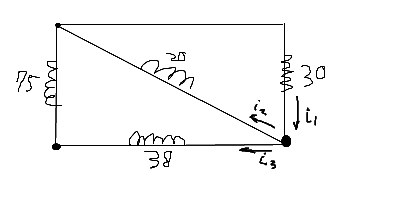

It looks like the current splits right? So would they be in parallel? (sorry for the crappy drawing)
They are in parallel because their terminals are connected between two common points.

Yes, at the right end of the circuit, the 18 and 12 are connected in series, but that combination is in parallel with the 20. The combination of these three is in series with the 38.

Combined 30 is in parallel with 20. Their parallel equivalent is in series with 38. This series-parallel stuff goes on and the circuit reduces to a single equivalent inductance between the given terminals.

Look at the two ends of 30uH and 20uH. They are connected between same two points i.e. the diagonal points in this case. So, between those same points, you can put the equivalent of 30||20 i.e. 12uH. Now, again assume some current through that 12uH. That same current will flow through 38uH, without splitting. This means 12 and 38 are in series. They are not in parallel because their ends are not connected between same two points, as are of 30 and 20 in the above picture.
