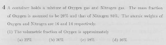

I have tried to change mass of oxygen into mol and I got ratio of oxygen and nitrogen. And I don't really know what to do.
In common terminology, the term volume fraction is used synonymously with mole fraction.

phoenix95 said:
Well done.
Now try using Ideal gas law. Use the mole ratio you obtained.
Do you mean mol of oxygen / mol of nitrogen is equal to volume of oxygen / volume of nitrogen? But I still don't know how to solve.
Let's see the details of what you did.
I got molO2/molN2 = 2.8/12.8 and from your comment I understand that volumeO2/volumeN2 = 2.8/12.8
This is incorrect. If you take as a basis 1 kg of gas mixture, what is the mass of oxygen in the mixture? What is the mass of nitrogen in the mixture? What are the number of moles of oxygen in the mixture? What are the number of moles of nitrogen in the mixture? What is the mole fraction oxygen? What is the mole fraction nitrogen?
In 1kg ,mass of O2 = 0.2 kg
mass of N2 = 0.8 kg
mole of O2 = 12.5
mole of N2 = 28.6
So total mole is 41.1 : mole fraction O2 = 12.5/41.1
mole fraction N2 = 28.6/41.1
mass of N2 = 0.8 kg
mole of O2 = 12.5
Moles O2 = 6.25
Chestermiller said:
Moles O2 = 6.25

Chestermiller said:
Moles O2 = 6.25
Thanks I got the answer now, is it 6.25/6.25+28.6 right?
