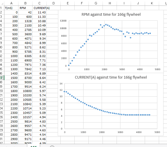

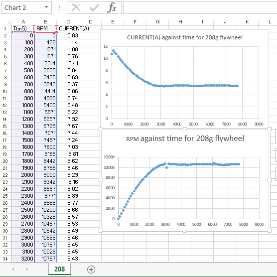

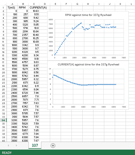

Hi Just wondering if someone could help me! I need to know how much torque and RPM a motor will output for a given load (0.75kg), the only information I've been given is how the RPM and current vary with time for 4 different flywheels of masses 118g 166g 208g and 337g! the dyno test datasheet for which can be found in excel format here! the voltage was always 8 volts during the dyno testing

From your data, it sounds like you can find electrical power input, mechanical power output, torque output and efficiency all vs. rpm for the motor.
These are the equation you'll use:
P=IV (where 'I' is current)
T=Iα (Where 'I' is moment of inertia, you'll need to find it for each flywheel.)
P=Tω
η = Pout / Pin
Compare your results for each flywheel, they should be the same/similar.
You can then apply those specs to your model car and find acceleration & velocity over the 18m, this could be done in excel or MATLAB etc.
the difficult part is estimating the frictional losses of your car (rolling resistance, air resistance, transmission losses etc). You may also need to consider the current output of the batteries you plan on using.
If you plan on building this thing I suggest making you gear ratio adjustable so peak performance can be found via testing as it's unlikely your loss estimations will be accurate.

  • Spreadsheet with columns T(mS), RPM and CURRENT(A) and two line-marker charts: RPM against time for 166g flywheel rising to about 11000 then levelling near 9000, and CURRENT(A) against time falling from about 11.4 to about 4.3.
  • Spreadsheet data for a 208g flywheel with columns T(mS), RPM and CURRENT(A), plus two line charts: CURRENT(A) against time, falling from about 11 A to a plateau near 5.5 A, and RPM against time, rising to about 10,800 then levelling off.
  • Spreadsheet table of T(mS), RPM and CURRENT(A) values for a 337 g flywheel, with two scatter graphs: RPM against time, rising to about 7000 then levelling, and CURRENT(A) against time, falling from about 11 A to about 8 A.
So just to be sure, I am to take the average torque from the flywheels and apply that to my car since the load on the motor is different?
Not the average torque. The torque the motor applies to the flywheel varies with RPM, the same applies to the torque the motor applies to the wheels of your car.
What you want is a torque vs RPM scatter plot for each experiment then use excel to apply a trend line to find the best fit equation for that plot. Compare each equation, they should be similar. Maybe find the average of the 4 equations. They should be straight lines that vary from stall torque to no load speed.
The equation can be used in the model car calculation to find the torque output of the motor for any given RPM.
This model car calcs can be done via an iterative method like so:
At t1 = 0, and v1=0, calculate a1 from torque output at RPM=0 (this will be stall torque)
at t2 = 0.01 find v2 assuming a1 was constant between t1 and t2, calc a2 from v2
at t3 = 0.02 find v3 assuming a2 was constant between t2 and t3, calc a3 from v3
repeat until 18 metres have been covered
You could probably get away with a larger time step than 0.01 seconds
This is a basic numerical method for an ODE
https://en.wikipedia.org/wiki/Numerical_methods_for_ordinary_differential_equations
I did a very similar project a couple years ago, I had much better results finding and using the manufacturers motor specs rather than using the experimental specs we were given, so that's something you could look into.
I am confused by the flywheel rpm and current plots. Admittedly the time to speed will vary because the rotational inertia is different for each weight, but once the flywheels are to speed, which is indicated on each graph by the horizontal lines, there should be no effect on the motor by the flywheels' weight and the terminal rpm and current should be the same for all of the flywheels; which, clearly is not what is indicated on the graphs. So, there must be some external forces involved like bearing friction variations due to the lateral flywheel weight or air friction variations due to increasing flywheel diameters with weight. As a result, I don't see how these graphs can be of any help in determining the acceleration of the model car based upon their data.
