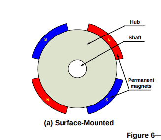

I have a 3 Phase low voltage BLDC but i have a problem of driving it using a Nucleo microcontroller combined with a extension board
Hello Community,
i have BLDC motor with General parameters are 3 Phase motor with 4 Poles, 36V, 7.3A rated current, 4000RPM rated speed.
you can check datasheet on link below
The first question is how many Pair of Poles does this motor have? 2 or 4?

4 poles = 2 pole pairs.
