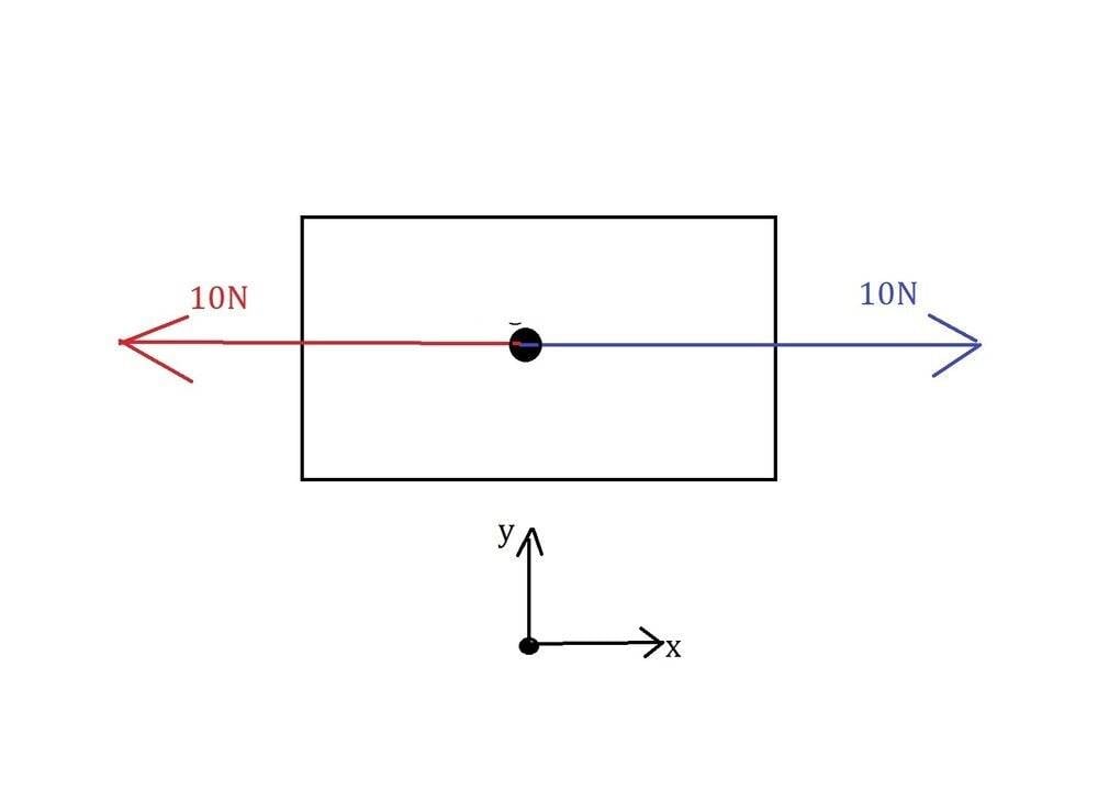

How do I know is this object at rest,moving to the left or moving to the right ?

My friend look at this object and say: this object can only stay at same position,he said imagine two mens pulls same object with rope with same force in opposite direction,so object must be at rest.
But if this object is plane ,and red force is drag and blue is thrust ,than object moving to the right..
So it seems we don't know from forces vector,what happening with this object..
Is now clear where confusion comes?

I draw refernece frame origin in my picture

Do you see where is origin on my reference frame in my picture,what else I need to draw?

Imagine human eyese is at origin of frame and looking at this object..
What happened with this object from human perspective?
That is correct. From the forces you only know the acceleration. You cannot determine the velocity from the forces alone. In fact, the object could even be moving up or down.
In order to determine the motion completely in addition to the forces you must also specify the initial conditions: the initial position and the initial velocity.
How is possible to object moves up and down if forces act only left and right?
Initial positon is at this place like its drawn at picture and initial velocity is zero in relation to origin at picture..
If its initial velocity were up then it would continue to move up at the same speed even with forces only left and right.
John Mcrain said:
Initial positon is at this place like its drawn at picture and initial velocity is zero in realtion to origin at picture..
Then it starts at rest and remains at rest. It does not move. Is that clear why? There is no net force to cause it to accelerate. Since it doesn't accelerate its velocity doesn't change. Since its velocity starts at zero and doesn't change then it stays at zero. Since its velocity is zero it is at rest.
Forces produce acceleration, not velocity. That was Newton's key insight over Aristotle.

Ok thanks for answer,so answer on my qestion lie in inital conditions.
So if inital conditions was moving to the right at 100km/h,then object is still moving to the right at 100km/h?
Yes! Exactly

John Mcrain said:
... initial velocity is zero in relation to origin ...
Then in that frame it will remain zero.
It's not marked on the diagram so you don't know.
