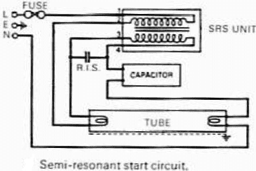

Incidentally, I have been more familiar with this circuit for fluorescent lights:
I wonder why you chose the resonant one?
Most fluorescent fixtures today that are used in homes ect., have instant start. I haven't seen many fixtures with removable "starters" like the one in your picture for a long time. I had assumed that the OPs source, which showed a "instant start" ballast, was a resonant one.
