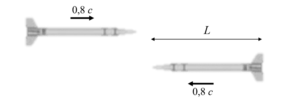

Two rockets, both with lenght L, travel at opposite directions with speed 0.8c relative to the distant stars. Calculate how much time it will pass, relative to an observer that is moving along with one of the rockets, since the moment the rockets cross each other until they have completely surpassed one another.
ϒ=sqrt(1-v²/c²)
Length contraction, time dilation
Firstly, I calculated the relative speed between the two rockets, finding v=1.6c/1.64. Then, I applied the length contraction: the length of the moving rocket will be 0.6L due to this phenomena, so the total distance traveled by one rocket, with respect to the the other, will be 1.6L. Therefore, the time they will take to pass one another will be
t=1.6L/(1.6c/1.64)=1.64L/c.
Is this correct? How would I solve the problem finding the time with respect to the distant stars and then applying the time dilation?
Thanks!

Your reasoning looks fine. I did not check the numerical computations.

Okay, so v = ~0.9756c
That's the length contraction as measured in the frame that the rockets are traveling at 0.8c relative to.
You've already determined that, as measured from either rocket, the relative speed is 0.9756c. This is what you need to use to determine the length contraction of the other rocket as measured by either of the rockets.

The two important events are the event where the noses of the rockets pass each other and the event where the tails of the rockets pass each other.
In what frame of reference do these two events occur at the same place?
What is the time interval between the two events in this frame?

In a fixed inertial frame of reference (distant stars), the events would occur at the same place, let's say, at the origin of the reference frame. In this frame, both rockets will have their lenghts contracted:
$$L'=L\sqrt{1-\beta^2}$$
As one of the rockets moves to the right with speed ##\beta c##, the other moves to the left with the same speed, so the total displacement will be equal ##L'##. Therefore, the time between events will be
$$\Delta t_0=\frac{L'}{\beta c}=L\frac{\sqrt{1-\beta^2}}{\beta c}$$
As in this reference frame the events are located in the same space coordinate, the time interval I just calculated should be the proper time, right? Hence, the time in the reference frame of one of the rockets would be
$$\Delta t=\frac{\Delta t_0}{\sqrt{1-\beta^2}}=\frac{L}{\beta c}$$
But this is the result expected by galilean relativity, is this right?

That all looks good. Yes, a surprising result!

The second ship is a red herring. As the relevant events are colocated in the star frame, let us put the spatial origin of the star frame in that point. The question becomes: "How long does it take the origin of the star frame to pass the rocket as seen in the rocket frame?"
I assume nobody has conceptual problems with this one ... :wink:
(And if so, the solution is the length of the rocket divided by the speed of the origin of the star frame, which is ##L/v##.)
