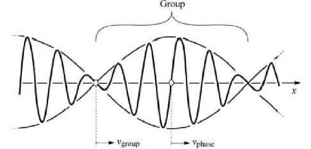

How fast are the de Broglie pilot waves? Do they move at the particle group or phase velocity?
Is the phase velocity really faster than c as it weaves around the particle?
As for all other waves, the peak of the wave packet moves with the group velocity.

Demystifier. For real waves.. why is the velocity of the guided particle zero? And where is the complex wave above?
Doesn't the pilot wave moves in 3D since the particle is in 3D?
