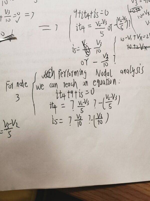

How do we determine whether this element in circuit is negative or positive(Nodal analysis)?
Nodal analysis
Aren't the +- signs on the selected voltage source enough?
