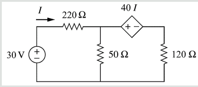

Determine the current I (in Amperes) in the circuit below using nodal analysis.
Ans: 0.123A

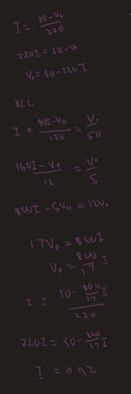

Tried mesh analysis and got it but didnt for nodal analysis
40I-V0? Subtracting a voltage from a current?
40I is from the current controlled voltage source. Isn't 40I in volts?
The rotated square (diamond) symbol with '+ -' is a controlled voltage source.
https://1.bp.blogspot.com/-VWAqITUrvhA/UY-k_NBxwfI/AAAAAAAAAUM/BPVlWJIFgXQ/s1600/sources.png
You can tell it's a voltage source because the '+ -' indicates polarity (as opposed to an arrow for a current source indicating current's direction).
'40I' indicates the output-voltage is numerically (in volts) 40 times the value of the current labelled 'I' (in amps) on the diagram.

wcjy said:

Can't see a problem. I also get I = 0.112(335)A and (for information) = 5.28(634) V. If you plug these values into check, you find that they give correctly balanced currents. Are you certain the answer should be 0.123A?
You could post your mesh analysis for checking. But purple on a black background is pretty eye-unfriendly and probably puts a lot of people off. (Typed-up using Latex is the preferred method.)

the system said the correct answer was 0.123. But anyways thanks, many people got 0.112 also. probably the answer is wrong. Gonna check with my professor.
My mesh analysis was wrong. I initially got 0.112 as well but i somehow tweak it to 0.123 thinking it was correct. Looking back, the change that i did, did not make any sense.
Anyways thanks so much for helping!
Ok, I'd never come across that concept.
But the correct way to specify its value would be with units, namely, as 40IΩ.
Yes. Also, it's in series with a resistor, which doesn't make a lot of sense for a current source.
It's not nodal analysis, I prefer the source transformation (Thevenin) approach, but this is the answer. You get the erroneous solution by reversing the polarity of the dependent source [ (1+r/R2) ⇒ (1-r/R2) ].
True, but by convention the units are usually omitted from the diagram and are assumed to be appropriate for the "conversion" implied by the sensed value and resulting output of the controlled source.
If units were specified on this diagram they would be more likely to take the form of Volts/Amp in order to indicate that so many volts are produced for a given current in amps, rather than being "reduced" from V/A to Ohms.
A similar convention occurs for the ##\beta ## value for transistors, where a simple apparently unitless value is given such as 200. In reality it represents the ratio of collector current to base current, the current amplification factor for the transistor, and so really should have units of Amps per Amp.

yea the answer is wrong!
