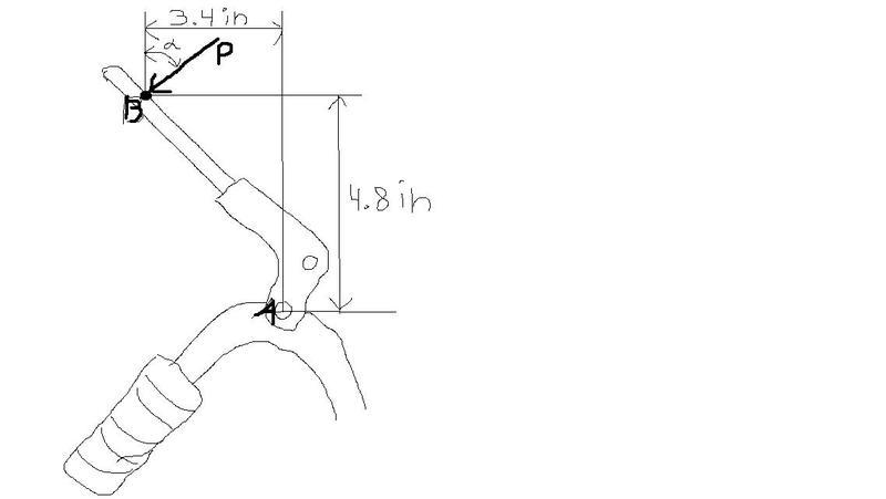

a 2.9 lb force P is appplied to the lever which controls the auger of a snowblower. determine the value of alpha knowing that the moment of P about A is counterclockwise and has a magnitude of 17 lb*in
i thought i could do it using moment= F*d
so 17=2.9 tan^-1(alpha)*4.8 see picture attatched
i did it this way and i was a couple of decimas off so if someone can point me in the right direction thank you
  • Hand-drawn diagram of a snowblower lever pivoting at point A, with point B on the lever, force P applied at angle alpha, and dimensions 3.4 in horizontal and 4.8 in vertical.
M = F*d only applies if your moment arm is perpendicular to the line of action of the force.
This is a 2-D problem so you have 3 equations that you can write down. Once that's done, you can see how to solve for the angle.
