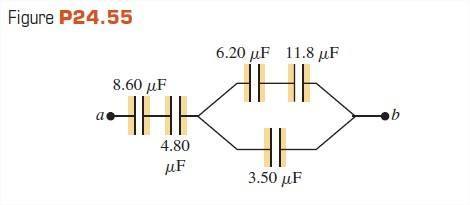

For the capacitor network shown in Fig. P24.55, the potential difference across ab is 12.0V. Find (a) the total energy stored in this network and (b) the energy stored in the 4.80-μF capacitor.

I found part A:
C1 = 8.6E-6
C2 = 4.8E-6
Capacitors in Series:
1/Ceq = 1/C1 + 1/C2 + ...
1/Ceq = 1/(8.6E-6) + 1/(4.8E-6)
Ceq = 3.08E-6
C1 = 6.2E-6
C2 = 11.8E-6
1/Ceq = 1/(6.2E-6) + 1/(11.8E-6)
Ceq = 4.06E-6
C = 3.5E-6
Capacitors in Parallel:
Ceq = C1 + C2 + ...
Ceq = 3.5E-6 + 4.06E-6
Ceq = 7.56E-6
1/Ceq = 1/(7.56E-6) + 1/(3.08E-6)
Ceq = 2.19E-6
U = .5CV2
U = .5(2.19E-6)(122)
U = 1.58E-4 J
But then for part B I'm not really sure what to do. The voltage for the entire network is 12V, but I have no idea how I can use this info to find the potential energy for just one of the capacitors. Please help.
Determine the charge stored in the equivalent capacitor. How is it related to the charge of the 4.8μF capacitor?
