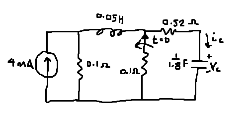

find iC(t) in the circuit and plot its waveform for t>=0.

just a bit confused would this be a parallel RLC after all? doesn't seem like it, cause after switch moves it seems to be in series, except for current srouce. then I would calculate R(eq) by adding those two resistance? 0.1+0.52=0.62ohm?? i also get iL(0-)=iL(0)=4mA and iC(0)=0 because no current through open circuit?
You could change the 4mA current source and its parallel 0.1 Ω resistor into its Thevenin equivalent. Then you'd definitely have a series circuit for t > 0.
i used source transformation and brought the 0.1ohm on top, and got an 0.4mV source. then i divided by the R(eq) of the two 0.1ohm resistors in series to get iL(0)=iL(0-)=2mA. then Vc(0) would be the voltage across the 0.1ohm resistors, 0.2mV. since iC(0)=iL(0) then using equaiton I=C(dv/dt) i get v'C(0)= iL(0)/C= 2mA*1.8=3.6mV. also, vC(infinity)=V(s)=0.4mV.
a (for series)= R/2L= 0.62ohm/(2*0.05)=6.2 np/s
w0 = LC^(-1/2)= 6 rad/s
since a>w0 it would be overdamped. so using the formula i listed i get s1=−4.64 and s2=−7.76
A1= (v'(0)-s2[v(0)-v(infnity)])/ s1-s2 = (3.6mV-(-7.76)(0.2mV-0.4mV))/3.12= 0.66mV
A2= -[(v'(0)-s1[v(0)-v(infnity)])/ s1-s2] = (3.6mV-(-4.64)(0.2mV-0.4mV))/3.12= -0.86mVvC(t) =vC(infnity) +A1*e^(s1t)+A2*e^(s2t)
vC(t) = 0.4mV+0.66mV*e^(-4.64t) - 0.86mV*e^(-7.76t)
so far i did this right?
Yup. Looks good so far.
