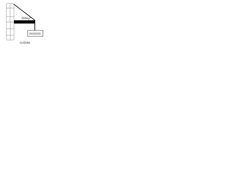

Find the force of tension in the chain. Determine the force of compression in the support bar. Be sure to include a free body diagram as part of your solution.
Now the only information given is a mass=20.4 kg and the angle 22 degrees.
If anyone could help me with this question, it would be greatly appreciated! THANK YOU SO MUCH in advance!
This is what I attempted to do to find a solution:
Fgravity= mg=20.4*9.8=200N
Then to find the tension I did the following:
Tcos(90-22degrees)-200N=0
0.375*T=200N
T=534N------> this would be our vertical component
Resolving horizontally gives:
x-Tcos(22)=0
x=534N*0.927
x=495N
A figure would be a great help.
hopefully your able to see that.. thanks again for taking the time to look at my post!
I did not work through your math, but it looks OK. So what is the problem? It looks like you have found your answer.
I just wasn't feeling very confident with how I got it, I guess I was just looking for a someone to back me up on it haha thanks!
