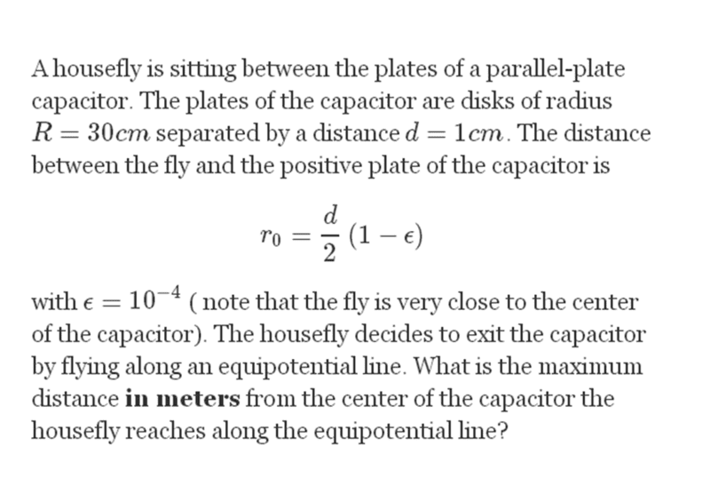

(see attachment)
I don't understand the question. There are equipotential lines everywhere in the region between the capacitor plates, even at ##r_0## from the left plate. So the fly could simply fly along that line and the answer should be ##\frac{d\epsilon}{2}##. Can anyone tell me if I am interpreting the question correctly?
Any help is appreciated. Thanks!
  • Typeset homework problem: a housefly between parallel-plate capacitor plates of radius R = 30 cm, separation d = 1 cm, starting at r0 = (d/2)(1 - ε) with ε = 10^-4, asking the maximum distance in meters from the center along an equipotential line.

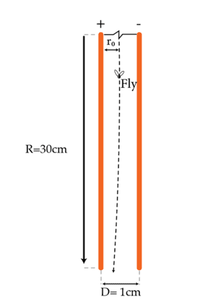

  • Diagram of two parallel vertical plates, one marked + on the left and one marked - on the right, separated by D = 1cm and each 30cm long (R = 30cm), with a dashed curved path labelled Fly starting at distance r0 from the left plate.
You are supposed to find what the equipotential surface looks like, and its maximum distance from the capacitors center. Note they are talking about lines, not surfaces. Which is the same thing because of the symmetry in the problem.

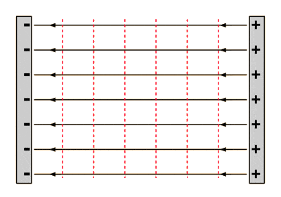

I still have no idea about this problem. Won't the equipotential lines look like as they are shown in the following figure:
Diagram of a parallel-plate capacitor with a minus-signed plate on the left and a plus-signed plate on the right, seven evenly spaced horizontal field lines pointing left, and six vertical dashed red equipotential lines.

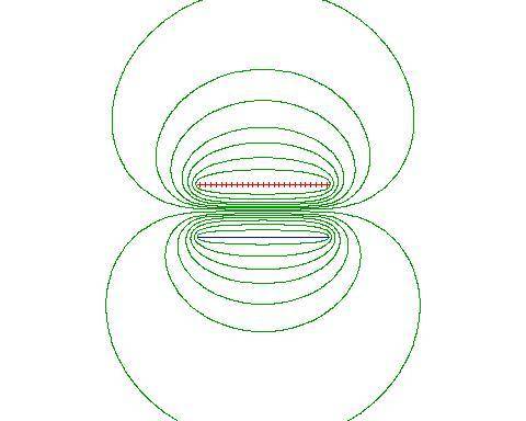

You need to consider what the equipotential lines look like when extended out from the region between the plates in order to get an idea of the path the fly will travel.

See the equipotential lines in the attachment. The surfaces would be obtained by rotating the figure about an axis perpendicular to the plates and passing through the center of the capacitor.
  • Green equipotential contour lines around two parallel plates drawn as a short red dashed line segment in the centre, forming nested closed curves above and below the plates.

See picture. The fly starts at P and reaches P' on the equipotential.
