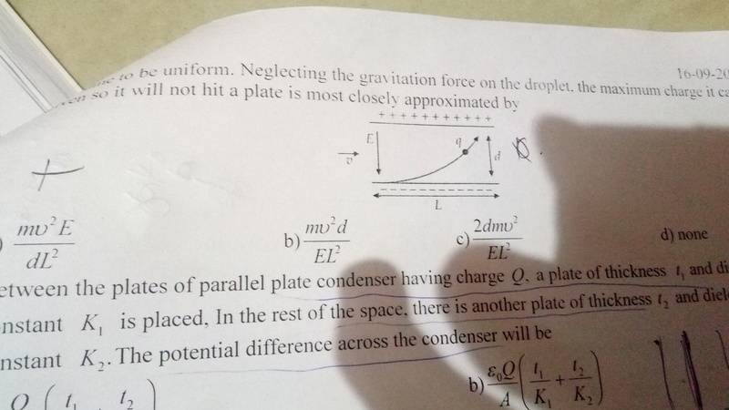

A negative charge of mass m enters into the field between two deflecting parallel plates with length 'l' separated by distance 'd' with a velocity 'v'.Assuming electric field to be uniform,find the maximum charge so that it will not hit a plate
Kinematic and electrostatic equations[/B]
F=qE
Work done=qEd
qEd=1/2mv^2
q=mv^2/Ed
I am not sure this is right and that is why i require help

Please see the diagram belowhttps://ibb.co/bDJxRe
Can you elaborate on why WE theorem cannot be used?
Note:gravity can be neglected
Ok I see now we neglect the gravitational force, so our acceleration is just ##a=\frac{Eq}{m} (1)##. Indeed v is perpendicular to e-field and the charge enters exactly at the bottom of the plates.
The exercise asks you the maximum charge so that it doesn't hit a plate, how work energy theorem could possibly help us with what the exercise asks? There is no way to use what the exercise ask us (not to hit a plate) together with WE theorem.
Instead use kinematics equations and determine what the charge should be so that
$$vt_0=L$$ , $$d\leq\frac{1}{2}at_0^2$$
Solve the first for ##t_0## and replace it in the second equation. Also use equation (1)
Just to say something more about why WE leads nowhere here.
WE theorem is about initial and final velocities and work done. The problem here deals with conditions on the spatial coordinates of the particle, those spatial coordinates appear nowhere in the WE theorem, that's why it can't be used here.

What is the use of L in this equation?
And is the final velocity of the charge 0?
No the velocity of the charge is not 0 when it exits the field.
In order for the particle not to hit the plate, its movement must be such so that when it has cover L distance in the x-axis and thus ready to exit the field, the distance covered in the y-axis must be smaller than d. Or more simply, when its x-coordinate becomes L, its y-coordinate must be smaller than d.
Analogy: a mass is thrown horizontally from a platform d meters above the ground. How far will it go horizontally before it hits the ground?
Thing here is you can't use g = 9.81 m/sec2, you need to come up with the equivalent of g due to electrostatic as opposed to gravitational attraction.
