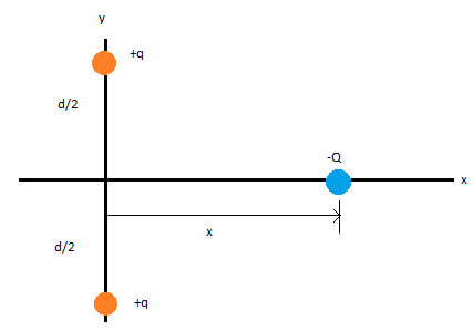

Two identical particles, each having charge +q, are fixed in space and separated by a distance d. A third particle with charge -Q is free to move and lies initially at rest on the perpendicular bisector of the two fixed charges a distance x from the midpoint between the two fixed charges. See image.
a) Show that if x is small compared with d, the motion of -Q is simple harmonic along the perpendicular bisector. Determine the period of that motion.
T=?
b) How fast will the charge -Q be moving when it is at the midpoint between the two fixed charges if initially it is released at a distance a<<d from the midpoint?
v_max=?
I know Coulomb's Law and Hooke's law might be used somehow, but that's about where I am.
I really don't even know where to start.

What is the force between each of the +q charges and the -Q charge?
Shouldn't the horizontal component of this force be the resultant force?
For something to move with SHM a = -ω2x (so use Newton's 2nd Law)
Your first two sentences I can see how to do. I just don't get how to relate F_e to SHM.

Find the resultant force and put it equal to ma
I think I've forgotten a bit too much from Physics I.
I have no clue how to get from Newton's Law to period. I see you posted a = -ω2x, but I don't have an option to use omega. I only have k_e, q, Q, m, d, and a.

Forget about for now.
What is the horizontal resultant force? (first 2 lines of the second post)
Ok..turns out I can't solve that either. I am working from some pos e-book which is impossible to use.
I thought you had to break them down into components, but my book doesn't do that. Looking at an example in the book I get...
[tex]F_e=(k_e|q||-Q|)/x^2[/tex]
I am assuming that the vertical components cancel leaving only the horizontal component.

The force between two charges Q1 and Q2 separated by a distance r is
F= kQ1Q2/r2
What is the distance from -Q to either +q charges?
Hence what is the force between each pair of charges?
Ah...the distance would be √(x^2+(d^2/4))?
Right, so then the force between +q and -Q at the top is? (This is the same as the force between -Q and +q at the bottom)
k|q||Q|/(√(x^2+(d^2/4))?
Right, so then what is the horizontal component of this force?
Working on the same problem here:
Wouldnt it be [(k|q||-Q|)/(d^2/4 + x^2)]cos(theta)? (then multiplied by 2 since the top and bottom combine?)

Yes. Also you can remove the | | signs and just write it as
[tex]F = \frac{-2kQq}{\frac{d^2}{4}+x^2}cos \theta[/tex]

You can forget about finding the ω for the moment.
Now that you have the component, looking at the triangle formed, can you use basic trigonometry to write cosθ in terms of d and x ?
Cos(theta)=sqrt(d^2/4+x^2)/x if I'm understanding what you're asking for correctly. Am I? :P Would you mind explaining what you're walking me through? I know you're going somewhere with this, so I'm curious, and obviously need to understand if I'm going to get it right, hehe.

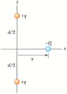

btw, here's the picture of the problem we're asked to do.
http://www.webassign.net/pse/p23-12.gif
thanks for the help

Well we are trying to show that it moves with SHM right? To do that, one usually finds the resultant force and then applies Newton's 2nd law. Thus far we are finding the resultant force.
I think you inverted it, it should be cosθ = x/√(d2/4+x2)
So now we have this
[tex]F = \frac{-2kQq}{\frac{d^2}{4}+x^2} \frac{x}{\sqrt{\frac{d^2}{4}+x^2}}[/tex]
Looks a bit complicated but that's ok. They say that x is small, so what does that mean for x2 or any other higher powers of x? (say x = 0.0001, x2 is smaller, x3 will be even smaller,etc.)
