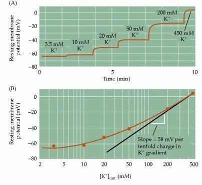

http://www.ncbi.nlm.nih.gov/bookshelf/br.fcgi?book=neurosci&part=A140
In summary, Hodgkin and Katz showed that the inside-negative resting potential arises because (1) the membrane of the resting neuron is more permeable to K+ than to any of the other ions present, and (2) there is more K+ inside the neuron than outside. The selective permeability to K+ is caused by K+-permeable membrane channels that are open in resting neurons, and the large K+ concentration gradient is, as noted, produced by membrane transporters that selectively accumulate K+ within neurons. Many subsequent studies have confirmed the general validity of these principles.

from this page :
the resting membrane potential varied as predicted with the logarithm of the K+ concentration, with a slope that approached 58 mV per tenfold change in K+ concentration (Figure 2.6B).
A slope that approached 58 mV per tenfold !
What an approximation. This curve is all but linear, fortunately.
If the curve was linear as theorized, every time a cell encountered some quite pure water, it will be destructed by an intense electric field.
We are all able to drink low salt water (normal water) and nothing happens.
58 mV is just RT/F*ln(10), I guess they put it there to signal system is approaching the Nernstian behavior.
Maybe I'm unable to understand the red words in the sentence?
We are here speaking about an outside concentration of K+. The normal value for this concentration is 4 mmol. Problems appear when the concentration reaches the value of...5 mmol. Death is quite certain when the concentration is 50 mmol.
Here, we have a slope that is constructed with values > 200 mmol.
