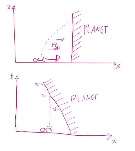

Below I have a sketch I made showing someone falling in a gravitational field vs someone moving in a straightline with the floor accelerating on them:

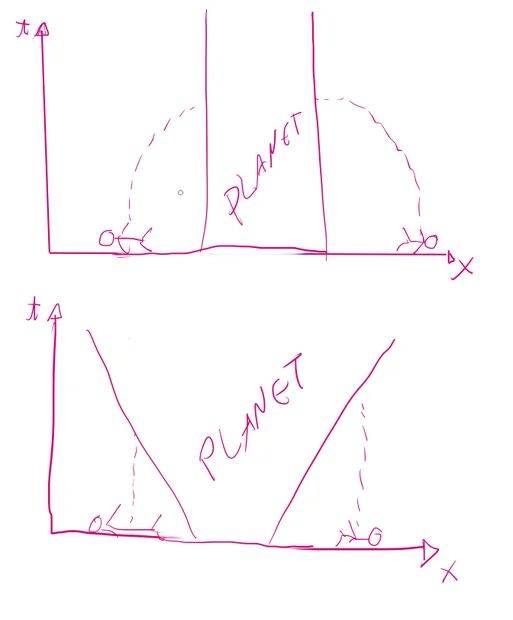

Both are fine reference frames, but planets are round, so if we add a second observer on the other side of the planet, what happens? Well, nothing really because the same way we argue that spacetime is contracting, we can say the planet is stretching, and all observers agree they can't tell weather they are in a gravitational field or if they are in an accelerated frame of reference. Drawing below:

My question as stated on the title is about a common example used to explain how relativity can be viewed as both an observer being in a gravitational field or in an accelerated frame of reference
The statement is that you can't tell the difference between being stationary on a planet's surface and being under acceleration in flat spacetime. It is only true strictly at a point, but it's also approximately true for small regions where tidal gravity is negligible. Once you start looking on the scale of whole planets (or on length scales comparable to the size of your source in general), you can't neglect tidal gravity and attempting to reconcile the global picture with the equivalence principle won't work
Thus we don't need to invoke "expanding planets" or anything of the sort.
