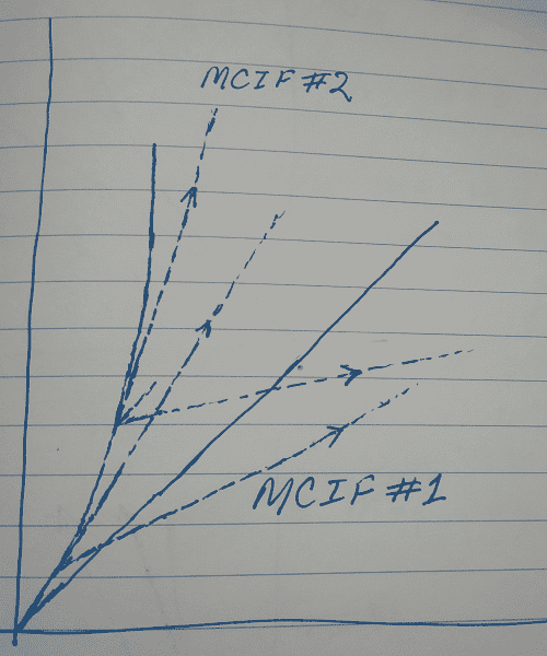

Hi again! I was attempting to understand the difficulties in stitching together MCIF's to specify a non-inertial frame, specifically on how we can encounter overlaps and missing areas. I'm not insisting that stitching MCIFs should be done - I'm sure the preprint you linked to gives a better description - just trying to get a better sense of the "overlap/missing area" problem.
Quick recap: In an experiment, a particle first decelerates for a while (non-zero accelerometer reading) and then enters an inertial state of motion (zero accelerometer reading). The particle's rest frame is definitely non-inertial. The previous discussion was on whether we can specify that particle's rest frame by stitching together its MCIFs. Both you and Dale pointed out that it's not at all recommended to do so.
Continuing, let's say I draw a spacetime diagram of the inertial frame that the particle ultimately ends up being at rest in (call that IRF ##R_0##):
The curved line is the worldline of the particle in ##R_0##. My guess is that the MCIF at any point ##p## of the particle's worldline can be specified as follows: the time axis of the MCIF should be parallel to the tangent to the worldline at ##p##. Also, we can fix the origin of the MCIF at ##p##.
So now the sequence of MCIFs constructed in this way at every point of the particle's worldline uniquely specify that worldline.
In order to construct the worldline given the sequence of MCIFs, can I not reverse the above procedure - i.e. the time axes of the MCIFs will give me a sequence of tangents and I can construct the worldline using those?
In this scenario, how will I run into the overlap / empty area problem?
  • #74
consider a zigzag world line, and you will see the problem in spades. That is, moving in the +x direction, then the -x, then +x, then -x.
  • #75
Why can I not use the same procedure in that case? I guess I can still trace out the tangents and reconstruct the worldline?
  • #76
Here are two diagrams of a slightly simpler scenario - a standard Twin Paradox. In each case the green line is the ship and the red lines represent a pair of planets. The ship travels most of the way from one planet to the other, then turns round and goes home. Both planets hold parties at the time of turnaround (according to their frame), marked by red crosses on their worldlines.
On the left hand diagram, I've marked in grey the slice of spacetime that is "during" the outbound leg according to the frame where the ship is at rest outbound. It's a slanted slice on this diagram because the Lorentz transforms tell you that a line of constant ##t'##, say ##t'=T'##, satisfies ##T'=\gamma(t-vx/c^2)##, which can be rearranged as ##t=T'/\gamma+vx/c^2##, clearly the equation of a line with gradient ##v/c^2##. The right hand diagram is the same, except I've marked the slice of spacetime that is "during" the inbound leg.
Note that the party on the left hand planet is not during the outbound leg or the inbound leg, and the party on the right hand planet is both during the inbound leg and during the outbound leg. Note also there are regions of spacetime that are before the first leg but after the second leg, and vice versa. This is all clearly unhelpful. If you naively take those two slices of the spacetime diagram and glue them together edge to edge, you are missing bits and double counting bits. It's analogous to printing two overlapping sections of Google maps and then gluing them together edge to edge and wondering why this town appears to have two High Streets.
Moving towards your problem, imagine that instead of having two legs the journey has three - outbound, rest, and return. Then four legs, then five, six and so on - basically constructing a polygonal approximation to your smooth curve. The problem doesn't go away as you add more line segments, and it never does. Even if you take the limit of infinitesimally short legs, each leg must be slightly non-parallel compared to the next one and therefore the infinitesimally thin slices of spacetime "during" that leg don't fit together.
That's the problem.
  • #77
That's the problem.
Awesome explanation! So what I understood from this: suppose ##M_1## is the comoving inertial frame with the rocket in the first leg (considering only "comoving" for now since this is a simple example in which the MCIF is the same throughout the first leg) and ##M_2## is the comoving inertial frame in the second leg.
In ##M_1##, the part of spacetime that corresponds to when the rocket was at rest in it, is a plane that is bounded by two horizontal lines (one for ##t=0## and the other for ##t=T##). Due to the Lorentz transformation, that plane transforms into the "slanting up" plane in the planet's spacetime diagram.
Similarly for ##M_2## the spacetime portion during which the rocket was at rest in it transforms into the "slanting down" plane.
So if I didn't know the rocket's worldline and only had these slanting up and slanting down planes to work with (the information given by the comoving inertial frames), and had to reconstruct the rocket's worldline with this info, I'd have to account for the overlaps and missing areas as you've shown clearly.
For this very simple example, it seems easy enough to do, but for more complicated motions in which a particle frequently and erratically changes its motion, this method will be a complete pain in the neck. Hope I got most of it right!
  • #78
You will get multiple labeling. That is, there will be large regions assigned to be simultaneous to 2 or more points on the origin world line. That means they will have multiple coordinates assigned to them , which is not a valid coordinate system.

Similarly for the red zone, I have a whole bunch of line segments that trace the rocket's potential worldline in the red zone. Out of all those potential worldline candidates in the green and red zones, the only ones that stay within their zones, don't cross over and don't leave gaps/overlaps are like this:
This is doable since this is a simple scenario, and as you said, would quickly become untenable for even mildly complicated situations.
The reasoning in this post seems valid, although I'd say it's backwards since the observable thing is the rocket's worldline, rather than its inertial frames.
