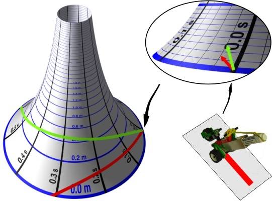

I've seen all the embedding diagrams and visual aids, showing that time is "stretched out" by gravity and that the geodesics bend into the more stretched-out region. I focus in particular on the representation where a sheet with one time and one space dimension is rolled into a cylinder, with the time dimension running around it. Spacetime curvature is then shown as a fattening of the cylinder, and the geodesics bend in the direction of this fattening. Here an object at rest in a region without curvature would just follow a circle around the cylinder perpendicular to its axis; but as soon as it encounters a bulging of the cylinder, it bends into the bulge.
Here my confusion is the same: I expect the trajectory to bend away from the bulge, not toward it.
The bulging cylinder picture at first seemed to help me, because I thought, yes, it's traveling a longer distance in spacetime. But then I said wait, this "longer distance" through stretched-out time involves fewer clock ticks, not more. The time is dilated so that there is "more of it" between ticks, but it's the ticks that matter. Isn't it?
I assume you refer to this:
http://www.adamtoons.de/physics/gravitation.swf
Note that this it a space-propertime diagram. The length of the path is the coordinate time, so all objects (including light) are advancing at the same rate in this diagram. There is no "traveling a longer distance in spacetime" here. All world lines have the same length in this diagram. The proper time is not the distance but the angular displacemnt around the cylinder. And that can be different for different objects.
To understand this go back to the simpler version:
http://www.adamtoons.de/physics/relativity.swf
Set:
coortinate time : 1s
check the box: stationary object
gravity : max
Now play around with the position of the stationary object and see how it affects the object's proper time after 1s of coordinate time. That is gravitational time dilation.

gabeeisenstei said:
The time-coordinate lines bend away from gravity, so straightening the path requires moving toward it. The straight line against (locally) constant curvature signifies constant acceleration (and increasing curvature implies increasing acceleration).
There is an alternative way to see it. Instead of imagining the space-time as stretched with geodesics bending towards the stretched areas, you can see space time having varibale density and the free-fall world-lines bending towards the denser areas, just like light beams in a medium with a variable optical density.
This method has the advantage that you don't need to embed a curved space-time diagram in higher dimensional space to visualize the curvature. So you can show one space-time dimension more: 2+1 space-time.
