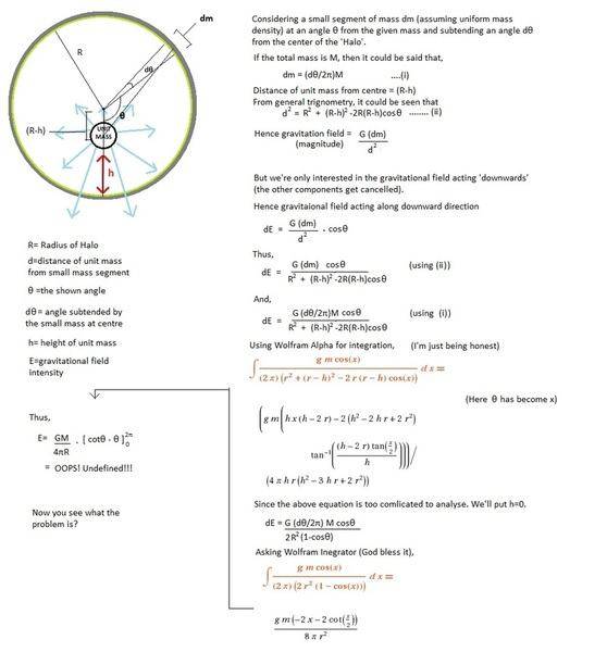

Downwards meant away from the centre and towards the inner surface of the ring. I'm assuming that all the gravity is due to actual mass of the ring and rotation isn't playing any part (because any such rotating ring would eventually stop or slow down after all the rotational energy is lost in pulling things down).
Since I noticed that this discussion wasn't really going as I expected, here's my attempt to the problem. I've used Wolfram Integrator to Integrate because so far I've learned only very basic level of lntegration (I'm in eleventh grade, India).
Point out mistakes if you feel, I'd love to be corrected.
Although, if it isn't due to actual gravity and is just centripetal force, the answer is already there. I don't debate that. I am interested in the 'gravity' rather than rotation.
But I do debate wkrasl. He says it should be zero. That's not true. Gravity field is zero only because of a special consequence of the Shell theorem.

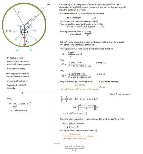

Alright, so if it's non-zero, how do we calculate it? I've tried doing it above, but failed miserably (no one seems to notice).
Would someone tell me what went wrong with my integration?
I've made some corrections, but the answer is still indeterminate.
Should it not be cot(θ/2) in that final result? (Still indeterminate, though)
Also, when you put h=0, you may be introducing a 0/0 situation, which will affect the subsequent conclusion.

Okay, I'll try putting h=1000 m (which is small compared to 10000 km)
Putting R=10000000 m
Putting G= the usual value
Putting M=1.7x10^17 kg (from wikipedia)
Hmmmm. This gives me 0.000275 as the answer. That's really less.
Here's a bit of arm waving.
Divide your ring into equal segments. (small as you like).
With the test mass at the centre, they are all equidistant from the mass so no net force.
Move towards the edge. Each segment on ' your side' of the the ring will have a corresponding piece on the other side of the ring. You will be nearer to each of the pieces on your side than to the mirror image segments on the other side. The effect of each segment will be proportional to 1/d2 so the sum of contributions from each of the nearer pieces will be far greater than the sum (same number) of all contributions from their equivalent pieces. But the number of segments involved is only a linear function of your position on the radius. This has to result in a finite sum and not zero. In the limit, for a large ring and a small measurement frame, you would have a 'flat earth' situation.
This contrasts with the shell situation in which there are progressively more elements on the 'opposite wall' - a 'square law, in fact - which compensates the inverse square law for the force from each.
