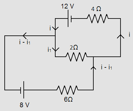

Here's how i drew the circuit with currents ...
Circuit schematic with Kirchhoff current labels: a 12 V battery and 4 Ω resistor on the top branch carrying i, a 2 Ω resistor carrying i1 in the middle, a 6 Ω resistor and 8 V battery on the bottom branch, with the remaining branch currents labelled i - i1.
And maybe you should look at some example of using Kirchhoff laws
Edit:
Here they are:
  • Circuit schematic with a 12 V battery and 4 Ω resistor in the top branch, a 2 Ω resistor in the middle branch, a 6 Ω resistor and 8 V battery in the bottom branch, with branch currents labelled i, i1, i - i1 and i - i1.
Circuit schematic with a 12 V battery and 4 Ω resistor in the top branch, a 2 Ω resistor in the middle branch, a 6 Ω resistor and 8 V battery in the bottom branch, with currents labelled i, i1 and i - i1.
Edit:
Here they are:
