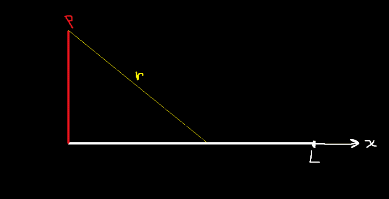

I want to find the potential at point P due to a finite, constant linear charge density λ, of length L.
first, if i wanted to find the x-component of the E-field at point P..
$$E=\int{\frac{k(λdx)}{r^2}}cosθ$$
$$r=\sqrt{z^2+x^2}$$
$$cosθ=\frac{x}{\sqrt{z^2+x^2}}$$
$$E=kλ\int{\frac{1}{z^2+x^2}}\frac{x}{\sqrt{z^2+x^2}}dx$$
evaluated from 0 to L yields..
$$-kλ(\frac{1}{z^2+L^2}-\frac{1}{\sqrt{z^2}})$$
when we did found the potential at piont P in class, we did the following though
$$V_{p}= -\int{\vec{E}\cdot d\vec{r}cosθ}$$
my confusion is, when we add the cosθ term, aren't we just finding the voltage of the x-component E-field?? Because, i thought we were trying to find the total voltage at point P, but this suggests otherwise doesn't it?

using dV=kq/r i get..
$$V=\int{\frac{k}{r}dq}=kλ\int{\frac{1}{\sqrt{x^2+z^2}}dx}$$
but this is equal to neither of the two equations... so now i have three equations.. which one is correct??

I won't deal with the E field. Much too laborious.Anyway, your equation here is where I'd put my money. Integrated from 0 to L.
