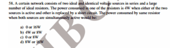

The first and foremost thing which I do not understand in this question is that there are many resistors present in the circuit , so how is it that we could relate power dissipated in one resistor to the power supplied by the batteries ??
But if I assume only one resistor , then I do get option a) .
That's correct.
When you make changes in the supply voltage, voltage across and current through each resistor in the network change proportionally. This is because resistors follow linear relation between V and I i.e. Ohm's law, irrespective of their configuration.
