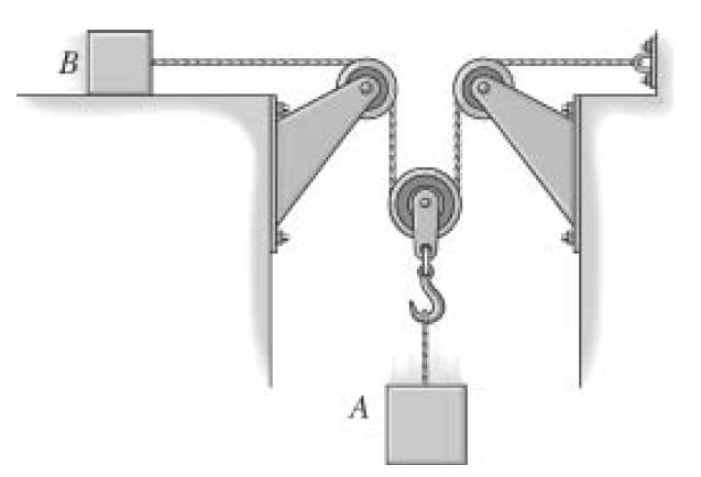

At a given instant block A of weight 10-lb is moving downward with speed 6 ft/s. Determine its speed at a later time t = 2s. Block B has a weight 4lb and the coefficient of kinetic friction between it and the horizontal plane is μ = 0.2. Neglect the mass of the pulleys and cord.
Diagram of a pulley system: block B on a horizontal surface connected by cord over a pulley to a hanging block A below a movable pulley, with a second pulley fixed at the right wall.
T = 3.385 [tex]a_{A}[/tex] = 10.403 [tex]ft/s^{2}[/tex] [tex]a_{B}[/tex] = - 20.806 [tex]ft/s^{2}[/tex]
not sure if these are correct seeing i get different answers.
T - [tex]\mu_{k}w_{B}[/tex] = [tex]\frac{-w_{B}}{g}a_{B}[/tex]
2T - [tex]w_{A} = (\frac{-w_{A}}{g}) (-a_{A})[/tex]
[tex]2a_{A} + a_{B} = 0[/tex]
since [tex]2a_{A} + a_{B} = 0[/tex] i'd solve for [tex]a_{A}[/tex] and [tex]a_{B}[/tex] in the first 2 equations and sub into the third one
[tex]2(\frac{2Tg}{w_{A}} - g) + (\frac{-Tg}{w_{B}} + \mu_{k}g)[/tex] = 0
then i solve for T
[tex]\frac{2g - \mu_{k}g}{g(\frac{4}{w_{A}} - \frac{1}{w_{B}})}[/tex] = T
T= 12N
then sub back into one of the first 2 equations to solve for either [tex]a_{A}[/tex] or [tex]a_{B}[/tex].
[tex]a_{B}[/tex] = -90.16[tex]ft/s^{2}[/tex]
[tex]a_{A}[/tex] = 45.08[tex]ft/s^{2}[/tex]
any help would b nice
cheers,

it was late...i changed the units, i was just used to [tex]m/s^{2}[/tex] from previous physics courses...
