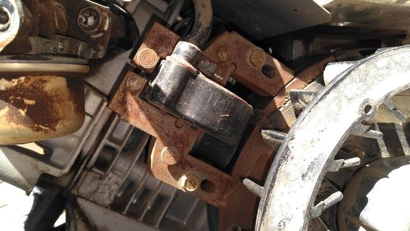

My speculation is there are generators in gas-powered lawnmowers and gas-powered weed eaters with pull strings, and I speculate that pulling the string on a gas-powered lawnmower or a gas-powered weed eater would turn a piece (possibly called a rotor) in a generator, which would generate electricity. Then my supposition is that this electricity would go to a spark plug and make a spark, starting the gasoline engines in lawnmowers and weed eaters.
Is my speculation correct? If not, how does pulling a string cause a gas-powered lawnmower or a gas-powered weed eater to start?
sevensages said:
From watching the video, I suppose that my speculation in the OP is correct.
Except that the "generator" is an integral part of the engine, and generates the spark anytime the motor is turning. It's just like your Internal Combustion Engine (ICE) car -- the starter motor spins the engine to circulate the fuel/air mixture and rotate the generator for the electrical spark generation. There is no separate electrical generator that is spun by the starter rope in your examples.
Pulling the drawstring turns a flywheel with a magnet on it, which moves the magnet over the wire going to a spark plug. This movement of a magnet over a wire generates electricity. It is a type of generator. This electricity causes a spark in a spark plug. I was basically correct.

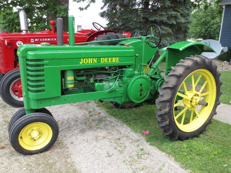

Mopeds have used a mechanism which winds up a spring with multiple pumps of a pedal. There is a clutch that is engaged to turn the engine. No cord-pull start.
Motorcycles with a kick starter do something similar but the motion on the pedal is directly coupled to the crankshaft instead of winding up a spring.
Golf carts have a starting mechanism that can turn the engine either direction for forward or reverse travel. I believe the system for keeping the battery up doubles as a starter. Coils around the flywheel I suspect.
Pony/donkey motors as described by @Baluncore .
The picture of the plane with someone turning the propeller posted by @berkeman .
The video linked by @Rive I have not watched but undoubtedly it gets the engine turning.
Pushing a vehicle down a hill to get it rolling and then engaging the clutch to get the engine to turn. May not work on the newest vehicles. I know it still works on older fuel injected vehicles with an ecm.
Tractors like these are started by grabbing the flywheel and turning it.
Green and yellow John Deere tractor with yellow spoked wheels, viewed from the side, parked on gravel beside a lawn. A red McCormick tractor is partly visible behind it.
International Harvester put the engine inline so an actual crank couples up to the front end of the engine directly to the crankshaft.
Video still with the title 'HAND CRANKING 1946 FARMALL M' showing a man in a cap and work clothes cranking a red vintage tractor's engine by hand, with stacked firewood in the background.
They all have one thing in common. They turn the engine by some means to get the fuel/air mixture drawn in as it would in ordinary operation and to fire the spark plug in the same manner as it would in ordinary operation. No special generator used only during starting for firing spark plugs. The same mechanism is used during starting that is used during normal running.
Go back even farther in time and there are large stationary non-diesel engines that used glow plugs. They are still started the same way. Get them turning.
@sevensages it seems you just want to 'be the most correct'. You are not.
