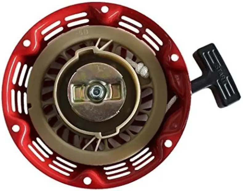

When I was about ten years old I decided I would fix the pull cord on our Briggs & Stratton lawn mower. I had tools. I took it apart. At some point I got to the coiled spring and when I pulled it out it inflated in way that Alan Guth would have been proud to have witnessed. Needless to say...
  • #56
That's got to be a dangerous activity pulling out a loaded spring. Mechanics risk their lives when replacing springs, shocks, and other loaded devices. One wrong move and the thing will slip with tremendous force.
  • #57
There's typically not a lot of torque on a recoil starter assembly for a lawnmower. Not to say the spring can't get away and maybe give someone a good startle. Doing real physical damage will likely not occur unless it gets to an eye. I've had many of them apart. If it's just a broken cord there is usually no reason to disassemble to the point of dealing with a spring.
The real danger in springs working on vehicles and such is suspension. Semi trucks use air brakes and the canisters that actuate the brakes can have a spring. They will be a two chamber canister. One chamber activates the brakes when air is applied. The other releases the brake when air is applied. That one functions as a parking brake and is the one with a spring. People have been killed messing with those not knowing the dangers.

The most comical pull cord starting process is with an old outboard motor on a small boat. The skipper can get very cross.
  • #60
The problem was that there wasn't enough stored energy to pull the flimsy cord back in. My plan (I was ten years old) was to wind it tighter.
Our old vacuum cleaner has the same problem. I'm not going to try and repair it but I'm not afraid of it.
