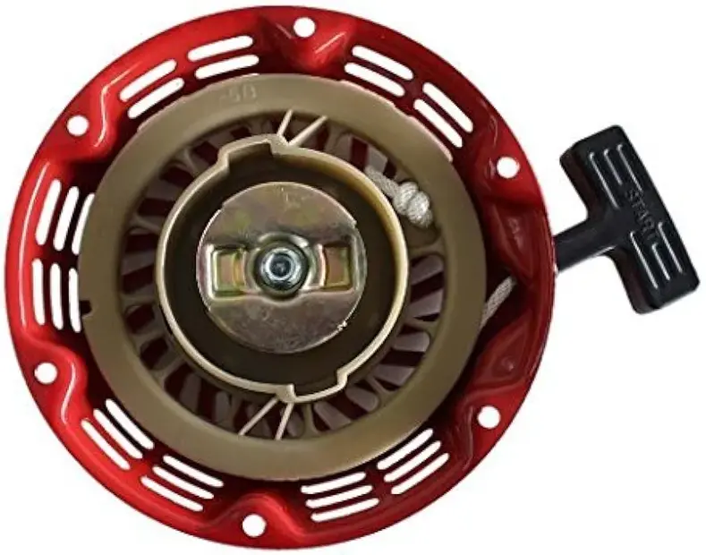

The problem was that there wasn't enough stored energy to pull the flimsy cord back in. My plan (I was ten years old) was to wind it tighter.
If you are ever in that situation again:
Notice the notch. Line the notch up next to where to cord goes out and slip the cord in the notch and wind around tightening the spring by one turn. You will obviously need to have enough cord out to get a full turn. No need to disassemble any farther than the pic shows.
Oh btw @JT Smith, you're excused for not knowing. Lol. Any ten year old that wants to be doing 'stuff' like that instead of being a bum gets my approval.
