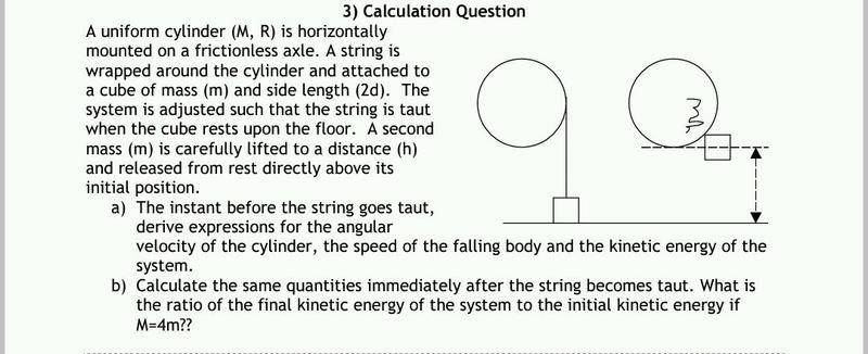

How is this second mass attached? Telling us it is raised such and such a distance above its initial position isn't very useful since we're not told its initial position. I assume it should be referring to the same mass m.
How is the mass lifted? You seem to have assumed it was by rotating the cylinder, so that as the mass descends the cylinder rotates. But in that case, the string would be taut as soon as the system is released. I suspect they mean the mass is lifted directly, so the string goes slack.
But the leaves a conundrum for what happens when the string goes taut again. There will be two impacts, apparently at the same time: the string going taut and the mass m hitting the table. That makes it impossible to determine anything. I suppose you have to assume the string goes taut first.
I was confused at that part too, the cube is the second mass which is m, I am not clear whether or not the cylinder rotates when the cube is being lifted in a way which is negligible since it is not stated? If I assume when the cube is being lifted, the cylinder does not rotate and that the string goes slack? does that mean there is no rotational energy in the system?
but then if my assumption is correct where it rotates when the cube is being lifted, would my calculations be correct?
As I said, if the cylinder is rotated to raise the cube then the string will go taut before anything moves. This makes part a trivial. There's a squiggle on the right hand picture which I suspect is supposed to be the slack string - it's got a bit displaced.
Ok I asked my professor for clarification, he confirmed that the cylinder stays still and that when the cube is being lifted the string is slack,
which I am confused on.. how am I to derive an angular velocity expression if the cylinder does not rotate?

For part b, as I posted before, I think you have to assume that the string goes taut an instant before the cube hits the table. In other words, treat it as though the table is no longer there.
