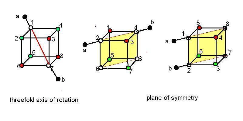

I'm trying to understand the second figure of the following webpage. The webpage simply solve it by 'symmetry', but I could not figure out its reasoning. Could someone explain how does it work? Thanks in advance.

I do not understand it either. But you can redraw the circuit by using symmetry. The symmetric points are at the same potential so they can be connected with a wire and considering them a single node. In the second problem, (the third cube in the attachment) the opposite nodes on the upper face of the cube are equivalent, (shown in red) and so are the opposite points on the bottom face (green). Points 4,5 make one node, so resistors (1,4) and (1,5) are parallel. Resistors (2,3) and 2,6) are also parallel. You can redraw the network between A and B and find parallel and series connected resistors, so it is easy the find the resultant resistance. See also https://www.physicsforums.com/showthread.php?t=557461
ehild
  • Three cube diagrams with numbered corner nodes: left, a threefold axis of rotation through nodes 1 and 7; middle and right, a plane of symmetry shown as a yellow shaded plane through the cube.
ahhh, thanks for the help, I get it now.
