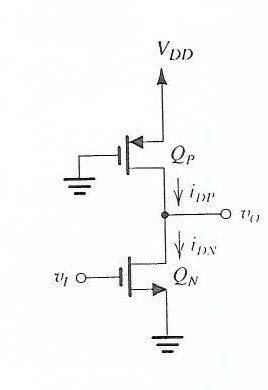

in the Pseudo NMOS inverter below
I don't understand how Qp acts as an active load, what I understand is that with this configuration Qp's Vgs is -5V which means that this transistor is always on (short circuit), now if the input to the circuit is low this means that Qn is off but Qp is on so the output will be high, but if the input is high this means that both Qn & Qp are on, now how come the output will be low? Shouldn't it be floating?
and I tried a simulation on Multisim and the results was as I expected, when the input was low the output was 5V, and when the input was high the output was 4.6V.

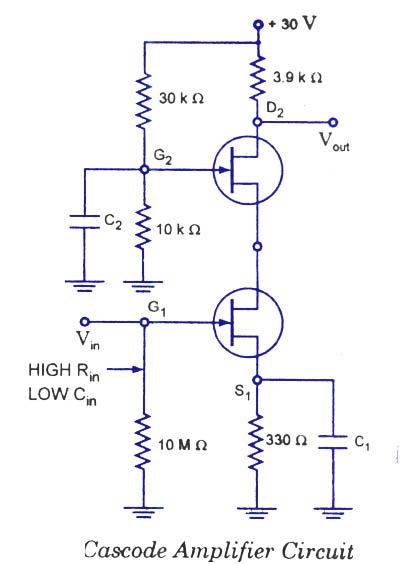

Cascode circuits like this one:
have both FETs of the same polarity and the top one is biassed with a voltage divider. The output is taken from the top, too, instead of at the junction of the two devices.
It seems that you could have a similar voltage divider on the first circuit, so that the top FET behaves like a constant current generator. Then the output would vary according to the resistance of the lower FET.
It is wrong in so many level! You cannot bias the MOSFET without a source resistor to setup the current. [itex]V_{GS}\;[/itex] varies a lot from transistor to transistor, you cannot set bias with a set voltage without degeneration resistors at the source. Also you cannot expect to set up a voltage using two constant current sources even if you set the two MOSFET up correctly as a constant current source. You are going to need negative feedback to set up a stable voltage. I designed plenty of MOSFET circuits and I know. With a circuit like this, even if you achieve constant current, it will stuck on one rail or the other because you cannot get the two current to be equal.
No, not a short circuit, a current source. The trick is that the top (pullup) device has to be a lot weaker than the bottom (main switching) device. This is typically achieved by area (cross section) ratio matching.
See if multisim will allow you to alter the cross section area of the devices model (I know spice does). Set the relative area of the top device to 0.1 and repeat your simulation.
It is a bad practice to set up a current source with a set voltage like the schematic. Vgs vary widely even with same model. Temperature drift is severe. People do it inside integrate circuits as current mirror because you can make the two adjacent transistor very close in characteristics, you can even scale current by scaling the geometry of the two transistors in the integrated circuits. This is a very common method to get constant current sources in ICs. When I was designing ICs, I still use degenerating resistor for more precision circuits.
Only if AND only if it is in the same die close to each other and at same orientation you can set up current source like this. AND even at that, nobody with the right mind will set up a voltage using two constant current source like in the schematic inside an IC. Constant current source has very high output impedance, all it takes is the top and bottom are off by nano amps, the voltage will be stuck on one rail or the other.
In discrete transistors, this is a very very bad idea. You don't need simulation to tell you that. In discrete transistor, there is no way for you to know the difference in doping of the two separate die. Look at the data sheets, they only give you a range of the typical turn on characteristic. It can vary by a mile in individual device.
Hi yungman. I believe that the context here is integrated circuits. I can see little reason to try and build an inverter like that out of discrete components, and much better to just use a pullup resistor if you did.
If you go back to the 1980's nmos devices like the 8085 uP were built in their millions using a very similar configuration to that given by the OP (but with a depletion mode nmos device as that current source pull-up).
