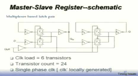

Master slave based edge triggered register
Schematic titled Master-Slave Register showing a multiplexer-based latch pair with transistors T1 to T8, inverters, inputs D and CLK, internal node Qint and output Q, with notes on clock load and transistor count.
Our professor is teaching this circuit and she mentioned there are 24 transistors. But I counted and it comes out to be 22
T1 to T4 needs 2 (transistor) * 4 = 8 transistors
Each inverter needs 2 transistors. so 7 inverters need 14 transistors.
total 22 transistors.
Unless we're also creating a Q' in the output, so that'll need 2 more transistors. But that's not mentioned in the circuit.
I think that is probably the answer. We'll always be needing complementary outputs. There is a Q’ available in the internals, but loading that point may upset internal switching/timing performance. An additional inverter will isolate the load.
