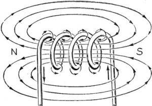

Tentative attempt at rudimentary explanation I wouldn't vouch for with my head:
Magnets are typically coated in conductive metal, like nickel, for extended durability. Even if themselves not conductive, their metallic coating will conduct electricity from the battery to the copper coil. The current will flow between + an - through the coil, creating a magnetic field in the process:
The induced magnetic field will interact with the field of the magnets, propelling the "train" forward.

The dup was deleted, with my explanation. The magnets act as conducting contacts with the bare wire coil. The very clever gadget is a linear motor.
The solenoid needs to be bare copper wire, not enamelled, so as the magnets rub along the copper some current flows through that short section of the coil. The ingenuity of some people knows no bounds. :)
Make sure the turns are not each touching, or the current will short out and not go the full distance around each turn. I expect the solenoid after winding will expand a bit, like a spring, so shorted turns should not be a problem.
