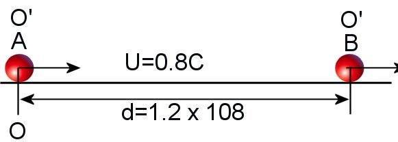

I give the problem and the solution. Can someone tell me if and where I am wrong? Thanks
We have an observer [tex]O'[/tex], who travels with constant speed [tex]U=0.8c[/tex], and another observer [tex]O[/tex] with speed [tex]0[/tex].
The Observer [tex]O'[/tex] is traveling from point [tex]A[/tex] to point [tex]B[/tex] [tex](1.2 \cdot 10^8m)[/tex].
Since we know the speed of [tex]O'[/tex], and the distance from [tex]A \rightarrow B[/tex], we can calculate the needed time [tex](t')[/tex] for the [tex]O'[/tex] to arrive to the point [tex]B[/tex].The observer [tex]O[/tex] counts the elapsed time, [tex]t_1[/tex] so the [tex]O'[/tex] to arrive to the point B.
[tex]U=\frac{d}{t'} \Rightarrow t'= \frac{d}{U} \Rightarrow t' = \frac{1.2 \cdot 10^8}{0.8c}[/tex]
[tex]t'=\frac{1.2 \cdot 10^8}{0.8 \cdot 3 \cdot 10^8} \Rightarrow t'=0.5s[/tex]
The time [tex]t'[/tex] is the dilated time for the Observer [tex]O'[/tex].Therefore, we can calculate the elapsed proper time [tex]t_0[/tex] for the Observer [tex]O'[/tex]
[tex]t'= \frac{t_0}{\sqrt{1-(\frac{u}{c})^2}} \Rightarrow t_0 =t\sqrt{1-(\frac{u}{c})^2}[/tex]
[tex]t_0=0.5 \sqrt{1-0.8^2} \Rightarrow t_0 = 0.3s[/tex]
So when the Observer [tex]O'[/tex] is at point B reads [tex]t_0=0.3s[/tex].
The first Observer who has zero speed is also counting the time needed for the Observer [tex]O'[/tex] to be to the point B. This means two things
So when the Observer [tex]O'[/tex] reads [tex]0.3s[/tex] the Observer [tex]O[/tex] reads [tex]0.75s[/tex], which is the time needed for the [tex]O'[/tex] to get from point [tex]A[/tex] to point [tex]B[/tex], plus the time needed for the information (light) to arrive to us.
