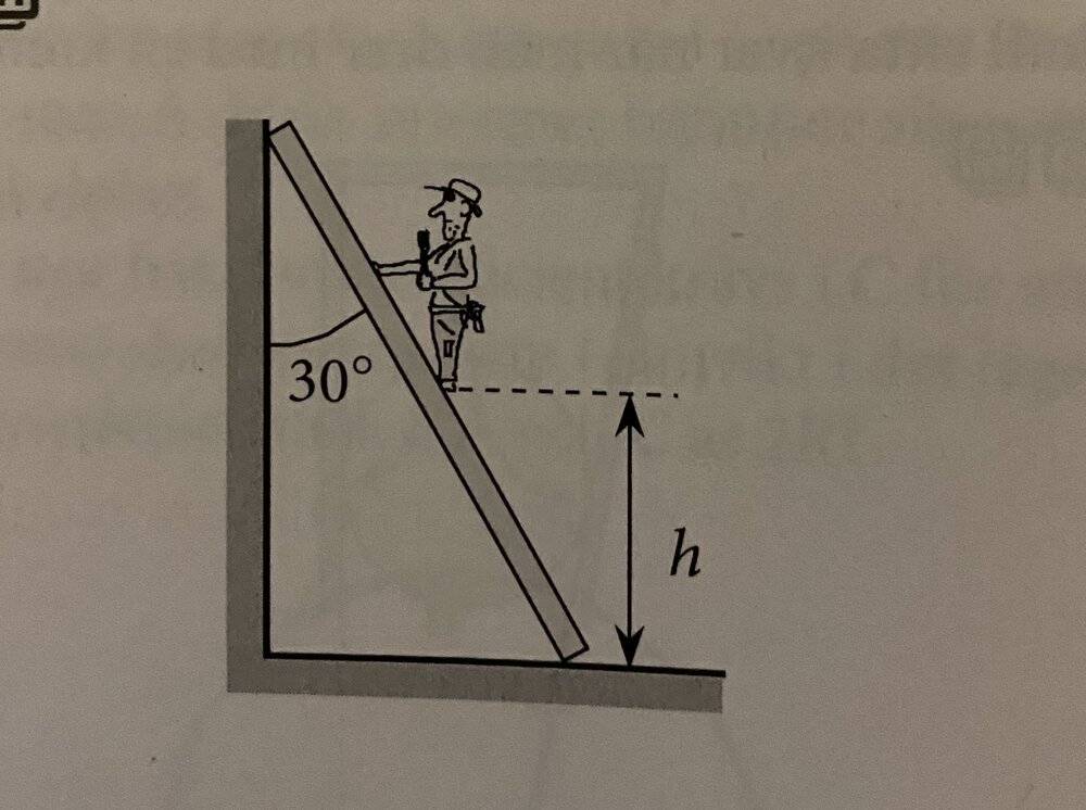

A person climbs a ladder like in the picture, how far can he climb up before the ladder starts sliding?
Ladder length 4m
Person weight 60kg
Ladder weight 10kg
Ladders coeficient of friction on both contact points 0,35

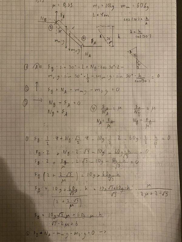

Look on picture two for my equations, I’m pretty sure my first three equations are correct as it’s the same on the answer paper I got. Answer paper only shows the three equations and correct answer so I have no idea how they got to it.

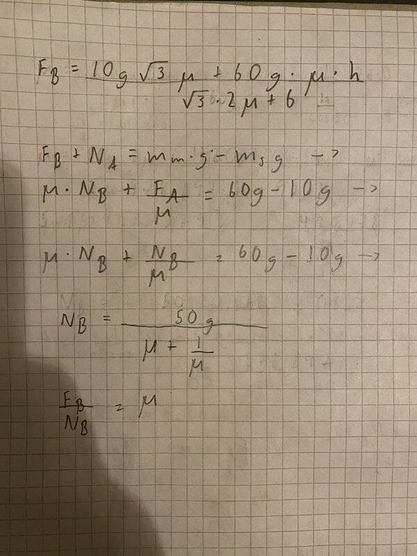

When I put the equations togheter And solve out ”h” i get like 1,5m something which is wrong. The answer is 2,34m. Can someone please look into this, did I simplify the equations wrong? Or is it something else. Have tried myself for like 2-3 hours and this is my last resort. Thanks in advance!
I found a sign error here:
I suggest that you start by using equations 2 through 4 to find ##N_B## and ##F_B##. Evaluatue these numerically and then substitute into equation 1 to find ##h##.
Changed that sign to + and now I got the correct answer! Thanks you so much.
I could only solve it with my method by placing in the equation for FB and NB into my last equation. But you wrote something about substituting into the first equation, how? Would it be easier to solve this kind of problem with another method?

It is generally easier to start with the simplest equations that allow you to eliminate some unknowns. The most complicated equation doesn't use FA or NA, so eliminate those first.
##F_A=N_B##
##N_A=N_B/\mu##
##F_B=N_B\mu##
##F_B+N_A=N_B\mu+N_B/\mu=M_m+M_s##
##N_B=\frac{\mu(M_m+M_s)}{1+\mu^2}##
##F_B=\frac{\mu^2(M_m+M_s)}{1+\mu^2}##
Etc.
