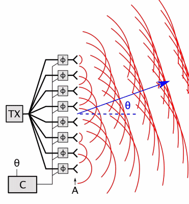

This wikipedia source mainly deals with antenna array transmission. Similar technology used as passive receivers on your spacecraft might be able to help locate a beacon in space. If not phase, then other differences among your antennae as the beacon RF impinges, could provide gross localization. The diagram shows a linear array but spheroids constructed of hexagonal sections resembling a radome could be used, particularly if comparing beacon signal strength instead of phase. Advantage over a rotating directional antenna receiver is that the array remains fixed to the moving spacecraft .
