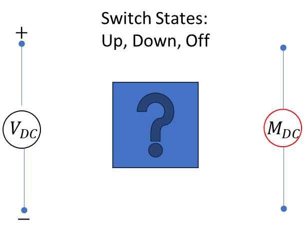

As far as I can tell there are three circuit states that control the recliner foot rest, raise it, lower it, and off. How is this wired, how does the switch function etc...? I assume the up and down switch flip the polarity across the motor, but that is all I can seem to reason out...

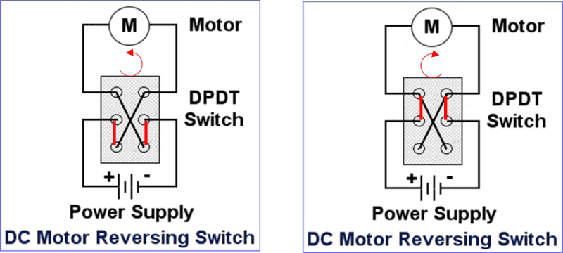

Rive said:
We had that not so long ago, as I recall....
Oh, here it is o0)
I'm sure I blew it off thinking "When am I going to need that"!
I already made the diagrams to be sure I understand, but I see they match the other thread.
Thank You!
