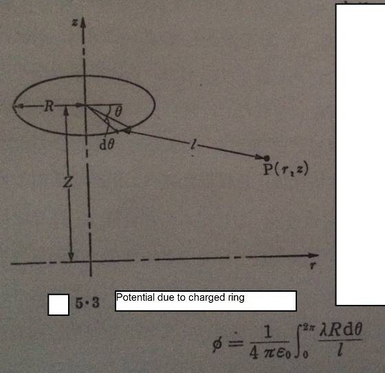

Hi.
I have no idea how to do this. It's complicated because the length here is a variable. I posted the same question before but there was a little mistake so I am reposting this again.
The picture below shows the potential due to ring charge.
Please show the full steps of deriving the equation of electrical potential shown in the picture. I have no idea how to start.
NOTE:
The electric potential of the revolving symmetrical ring electric charge related to the axis z as depicted in the diagram 5.3. It is commonplace to use complete circle integral function in the charge simulation method. If the position (height) of ring electric charge is Z, the radius is R, and the charge density is λ, the electric potential of the point P will be as represented in the next equation.
In the equation, l is the distance between the part of the ring charge dθ and P.
  • Diagram of a uniformly charged ring of radius R centred on the z axis at height Z, with point P(r, z) and distance l from a segment dθ to P; below it is the integral for the potential, phi = (1/(4 pi epsilon_0)) times the integral from 0 to 2 pi of lambda R dθ over l.

I can give you a hint where to start, but I am not allowed to provide full steps like you ask.
The electric potential of the revolving symmetrical ring electric charge...
... the picture does not show a revolving system - please check.
... related to the axis z as depicted in the diagram 5.3. It is commonplace to use complete circle integral function in the charge simulation method. If the position (height) of ring electric charge is Z, the radius is R, and the charge density is λ, the electric potential of the point P will be as represented in the next equation.
So how would you normally go about finding the potential due to a distribution of charge?
You problem seem to be the "l" is not fixed?
That is not a problem if you express l in terms of r and θ

It's ok, I have solved this problem!
Excellent - perhaps you can help out someone in a similar fix by posting the resolution?
