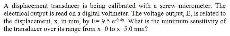

First, we define sensitivity as the change of an instrument or transducer's output per unit change in the measured quantity.
So to find the minimum sensitivity I simply plugged in the largest possible input (5.0 mm) into the equation:
E = 9.5e-0.4(5.0)
E = 1.286 V
Is this correct?
I would say no, that is in fact the "minimum voltage" you would expect to occur
I would associate sensitivity with rate of change of voltage with distance
So I would first have to take the derivative, and then plug in 5.0?
Doing this I would get an answer of -0.514 V/mm. So will my final answer be 0.514 V/mm, if I were to take the absolute value?
if you can explain why you choose 5 (which is a reasonable choice), it sounds like a plan
I chose a displacement of 5.0 mm because it will give me the smallest rate of change, whereas if I chose a number closer to 0, I would get a higher rate of change, which means higher sensitivity.
Also, do I keep the value negative, or take the absolute value? I don't think negative sensitivity makes sense.
may have to check you notes, it may be defined as the magnitude of rate of change as you're hinting
