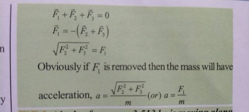

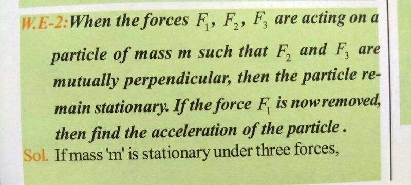

Image above is the question. Below image depicts solution.
if F1 is removed then the acceleration of that mass must be sum of accelerations of remaining forces. Right??
But answer says that acceleration of that mass is equal to acceleration of F1. I don't understand it. Can someone explain it??

If initial acceleration is 0 and you remove a force F, then the acceleration is -F/m (opposite to the removed force).

The sum of the remaining forces must be -F1, otherwise the mass would have been accelerating before F1 was removed.
If you include the direction in the acceleration, it is A=-F/m.

I don't like their answer. In should be a=-F1/m.
Oh I got it. It is just a typo. Right??

No. They are not including the direction vector. Note the F1 with and without the direction arrow on top.

I forget about the vector notation. Sorry for it.

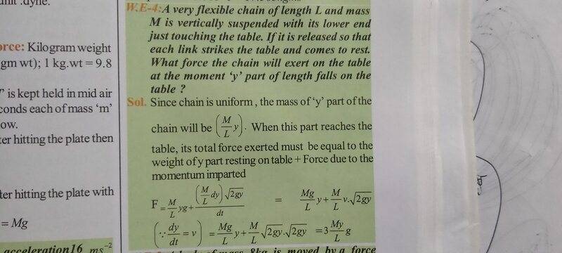

By the way I also have another example can you explain it??
What I don't understand in the following example is how did they got to know that the total force exerted must be equal to the weight of y part resting on table+ force due to the momentum imparted

If I throw a link against the wall, it will exert a momentary force on the wall.
If I throw a link onto a table, it will exert a momentary force and then come to rest on the table.
A link resting on the table exerts a downward force on the table.

Now I am slowly understanding the answer.

Scott can you explain how they got the momentum in the first equation. And also why did they considered momentum rather than downward force??
