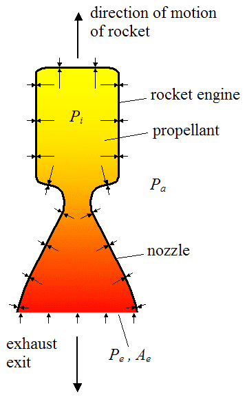

The same thing happens with a rocket (doesn't it?) where net reaction force on the inside of the combustion chamber produces a driving force.
The combustion chamber is closed at one end, and the nozzle is expanding in the flow direction, not narrowing like on the hose. That's where the propulsive force acts:
In the case of the hose those pressure forces act on the upstream fluid, not the nozzle. The net pressure force on the hose-nozzle itself is with the flow.
Yes - there is a difference but isn't that because of the expanding gases in the case of a rocket? There is still acceleration of the water in the nozzle and acceleration requires a force in the direction of that acceleration. That force must have an N3 companion. Where does that act? I suggest backwards, or we have a new method of propulsion.

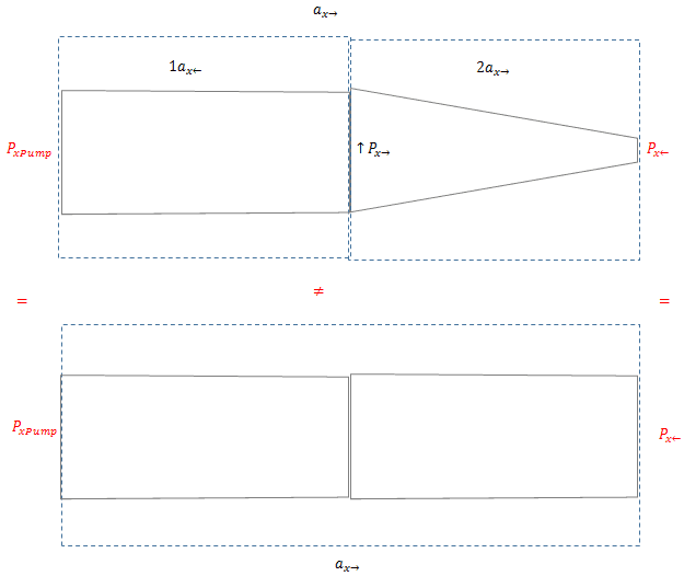

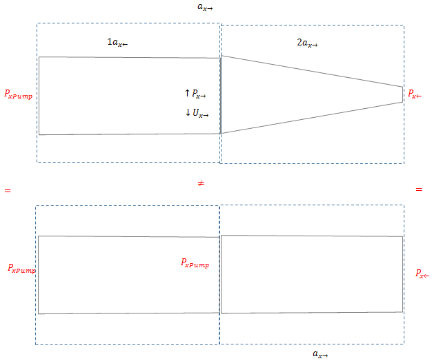

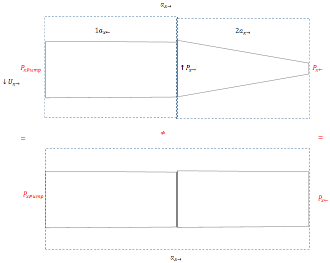

@Chestermiller . Yes that I think would solve the issue, as I see it we have two different scenarios ,
1 The control volume contains a constant diameter pipe 2A
2 The control volume contains a nozzle 2A to 1A
Assumptions were that the pipe is perfectly straight (so walls cannot receive a force)
The initial pressure say a pump is working constant at some fixed rate and that final pressure is atmospheric.
I am not talking about a curving hose I'm not sure how Sophie inferred Bernoullis to mean around bends instead of continuity equation

@Chestermiller The assumption you are making is that, if exit is fixed at atmospheric, then you can change the initial pressure Px→ but the scenario I gave is a fixed inlet pressure.
Sot that's fine but you must also recognise what happens in the preceding control volume
You have a fixed inlet pressure from the pump so if you've increased the exit pressure for this preceding control volume - the flow rate must slow (against the new adverse gradient Ux -ve to that point)
This is why the comparing the two scenarios comes important as while it appears the fluid has accelerated all we have really done by adding a nozzle is slowed it and sped it back up.
In each scenario (with or without the nozzle) the flow only travels at the rate commensurate with the initial and final pressure difference . The 'real net' acceleration is fully provided by the pressure differential - This is why there is no resultant force backwards

Yes but you have used continuity to relate them. So your assuming they are related to as you have done, from the areas and velocities change by continuity . but they are fixed from the pump and the exit. The presence of the nozzle doesn't change either of these.
This is what I believe confuses many people about this scenario. It appears from the math, that there is no resultant force resulting from fluid acceleration because the analysis doesn't show the impact upstream outside the control volume.
This is why I thought it best to show derivations for both scenarios. I thought it would quite clearly show that you couldn't have the same inlet pressures and velocities between the two examples.
