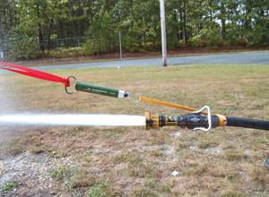

I did some googling on fire hose nozzle reactions. Here's a link
https://www.fireengineering.com/articles/print/volume-159/issue-4/features/measuring-and-demonstrating-nozzle-reaction.html
it shows a measurement of reaction force using a fish scale

  • #36
In this photo, the hose is obviously curved, which is the reason for a constraining force to be needed. If the hose were perfectly straight, no such force would be required.
