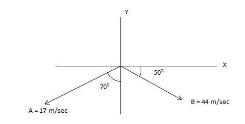

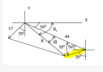

Find the resultant vector of vectors A and B shown in the figure.
##\large \frac {R}{Sin 70^0} = \frac {17}{Sin\alpha}##
244621
Solution:
By geometry method:
244622
Cosine law for the right side triangle.
##R^{2} = 17^{2} + 44^{2} - 2 (17)(14).cos 70^{0}##
##R = 41.39 m/sec##
By Sin law,
##\large\frac {R}{Sin 70^0} = \frac {17}{Sin\alpha}##
##sin \alpha = \large \frac{17.sin 70^{0}}{R} = \frac{17.sin 70^{0}}{41.39}##
##\alpha = 22.70^{0}##
##\theta_{x} = 50 + \alpha = 50 + 22.70##
##\theta_{x} = 72.70^{0}##

I am not asking about LATEX. I am asking about concept.
Yup. Looks good.
So your resultant vector has a magnitude of 41.39 m/s and makes an angle of ##72.70^\circ## clockwise from the positive ##x##-axis.​
You can check your answer using x-components and y-components.

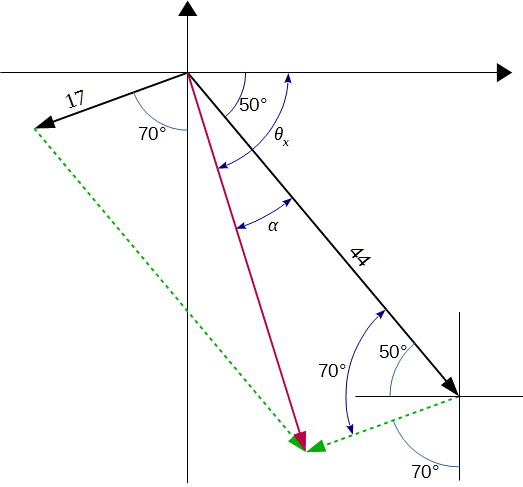

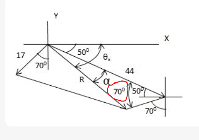

Please explain this sin law equation. ##\large \frac {R}{sin70_{0}} = \frac{17}{sin \alpha}##.?
##70^{0}## is not the full angle, It is just a portion of the angle. So how sine law is calculated on portion of the angle?
It's the full angle: the 70##^\circ## is shown in the right half of the figure (that you should redraw a bit more to scale).
244731
How ##17## included in the sine law? See, in the diagram, ##17## is far away from ##\alpha## so how it is included ?
Did you already re-draw the picture a bit more to scale as I suggested ?
Then you'll see more easily where the 17 is sitting: opposite the angle ##\alpha##.
Please do a little bit of pondering answers before shooting off yet another question :wink:
244732
For the record, it's also possible to calculate ##\alpha## without recourse to R or the sin rule. Referring to SammyS's very excellent diagram, drop a perpendicular from where the green arrows meet to the side of length 44. Then: $$ \tan{\alpha} = \frac{17\sin{70^\circ}}{44-17\cos{70^\circ}} $$ This is the 'tan rule' but unfortunately nobody ever teaches it in school!
